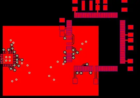

INTRODUCTION: I'm aiming to design an Ethernet connected system as a hobby ( ie. plenty of time but not wishing to spend much ). My design constraints would ideally be sticking to a 2 layer 100mm x 100mm PCB with 0.3mm min holes and 0.15mm min track/clearance, up to 0.6mm thin total stackup. The cost of producing a 4-layer PCB in my known manufacturer exceeds that of components at the quantities I need ( only one really, but up to 10 PCB go for the same cost in my particular case ).

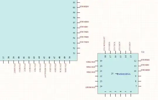

MY APPROACH: A ATSAME54N20 microcontoller with built-in Ethernet MAC connected with a RMII to a KSZ8091RNA PHY in Altium Designer.
Schematic of ATSAME54N20 and KSZ8091RNA
QUESTION 1: What are my odds of success? Maintaining 68ohms characteristic impedance to GND ( GND still not poured ) for RMII traces seems impossible even with the 0.6mm total height stackup option, yet maximum trace length is less than 30mm, with traces like CLK being 4mm long. Are ringing and reflection problems likely to arise in a circuit like this?
QUESTION 2: Both TX traces are routed together and separate from RX ones, though no length matching was done. Should I consider tight length matching tolerances?
QUESTION 3: The highlighted NET spares vías by going through two unused pins which would be set to high impedance. Is this common practice? Is signal integrity affected by doing this? Is using vias better practice?

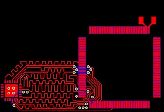

FOLLOW UP:
  • All RMII nets were length matched to 29.9mm +/- 0.1mm.
  • Unused pins weren't used for running traces.
  • Stackup consists of a 1.6mm total thickness board and no controlled impedance was made.
  • GND still needs to be poured, along with some 3.3V polygons, not breaching under any tracks.
Is this design better?
Does it look like it could work?

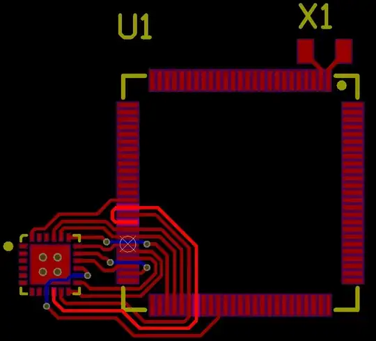

FOLLOW UP 2:

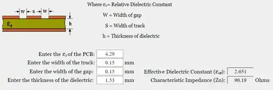

enter image description here - A coplanar waveguide with ground was implemented for a closer impedance match.
The most comprehensive answer to the correct transmission line impedance for RMII traces I found was Wikipedia:
The RMII signals are treated as lumped signals rather than transmission lines; no termination or controlled impedance is necessary; output drive (and thus slew rates) need to be as slow as possible (rise times from 1–5 ns) to permit this. Drivers should be able to drive 25 pF of capacitance which allows for PCB traces up to 0.30 m. At least the standard says the signals need not be treated as transmission lines. However, at 1 ns edge rates a trace longer than about 2.7 cm, transmission line effects could be a significant problem; at 5 ns, traces can be 5 times longer. The IEEE version of the related MII standard specifies 68 Ω trace impedance. National recommends running 50 Ω traces with 33 Ω (adds to driver output impedance) series termination resistors for either MII or RMII mode to reduce reflections. National also suggests that traces be kept under 0.15 m long and matched within 0.05 m on length to minimize skew.
Some others include the RMII v1.2 spec:
All connections are intended to be point-to-point connections on PCBs. Typically these connections can be treated as electrically short paths and transmission line reflections can be safely ignored. Neither a connector nor a characteristic impedance for electrically long PCB traces is within the scope of this specification. The output drive is recommended to be kept as low as possible to minimize board level noise and EMI.
And a Sun Microsystems guideline:
Like the MII signals, the GMII signals will be source terminated to preserve the signal integrity per the following equation: Rd (Buffer Impedance ) + Rs (Source Termination Impedance = Z0 (Transmission Line Impedance).
  • All RMII nets were length matched to 40mm +/- 0.1mm.
  • Unused pins weren't used for running signal traces.
  • Unused pins were used for GND and 3.3V connection.
  • Stackup consists of a 1.6mm total thickness board.
Is tying some pins to 3.3V or GND acceptable? I could do without this practice.
How many vias should I place along the coplanar waveguide? There's extra space for more vias ATM.
GND traces between signal traces get up to 0.15mm wide, is this OK?
Thanks in advance for your kind help answering ! I really appreciate it !
    This is a pretty risky design, but I think it will work for 10 Base T, which has pretty generous margins. But, it will be painful to maintain on a product or over long term. You will probably get some destructive reflections on the long traces, and there running your longer traces through extra pads may actually help because those pads will add capacitance and slow your edges down. You don't need to worry much about impedance matching on such short lengths. Time of flight (length) matching is more of a concern, but again 10Mbps should be pretty generous. – pscheidler Mar 07 '18 at 04:04
  • Thank you very much for the answer ! Shall I move the IC one more centimeter apart and try to match traces lengths? – Juan Manuel López Manzano Mar 07 '18 at 04:30
    A "NC" pin does not mean it isn't connected inside the chip: it means that you arent to connect to them. The reason for having NC pins on a chip vary, but they could be reserved pins, pins used for testing, etc. Connecting to them could cause unpredictable behavior. – TimB Mar 07 '18 at 06:06
    Thanks for posting the Follow-Up. I thought you said the stack-up with 0.6mm (which is a very thin PCB), not 1.6mm? Either way it doesn't make much difference to impedance calcs. Within the (undesirable) constraint of wanting to do this on 2-layer, I'd say this is a safer solution, and signal propagation difference has been dealt with (I suspect they never were at this speed). However you don't appear to have treated the impedance aspect of the design? The calcs I did in my Answer were for a coplanar-wave scenario, where you fill inbetween signals with Gnd, so they're now wrong. – Anthony May Mar 08 '18 at 19:40

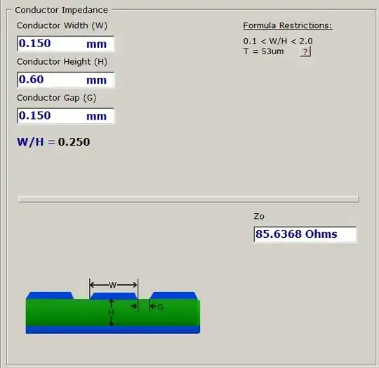

    Firstly, It's now ~140ohms (microstrip calc), previously ~86ohms (coplanar-wave calc). I'd urge you, at least for the learning exercise, to look up the source impedance of both ICs, confirm my back-of-the-envelope Z0 calc, and work out if you'll have a reflections/ringing problem (assuming receive end is Hi-Z). Secondly, all signals return through Ground, but this is especially important for high-speed (crosstalk, EMI, etc), so always have to be considered, otherwise you're only "half doing the job", so we're interested to see how you do the bottom-side gnd plane :-), if nothing top-side. – Anthony May Mar 08 '18 at 20:05
    this just came up on a random google which might help, if you're not familiar with transmission line theory & math. I don't personally endorse it, but it looks 'good enough' for this case :-) : http://web.cecs.pdx.edu/~greenwd/xmsnLine_notes.pdf – Anthony May Mar 08 '18 at 20:07

    @JuanManuelLópezManzano I like this much better. I have to keep biting my tongue & remembering that the overriding constraint to this design is that it's a 2-layer PCB, so I think it looks much more promising than your first cut. – Anthony May Mar 12 '18 at 02:52
    @JuanManuelLópezManzano However! "Unused pins were used for GND and 3.3V connection." Please clarify what you mean by this? By "unused pins", do you mean MCU's GPIO pins not in use? And you're using them for...what? – Anthony May Mar 12 '18 at 02:54
  • @Techydude Thanks for answering ! Some GPIO pins were connected to GND because they have signals traveling in the bottom layer underneath their pads. There's also one pin conected to 3.3V to avoid using one extra via. I could do without both. Shall I disconnect this pins from GND/3.3V? – Juan Manuel López Manzano Mar 12 '18 at 03:22
  • @TEMLIB the LAN8720 Eth Board you referenced is using 33Ω series resistors like one of the recommendations I found in Wikipedia. The reference design for the chosen microcontroller has 50Ω RMII traces complying with the same recommendation, yet it has 0Ω series resistors. Would 68Ω characteristic impedance without series resistor be a valid option? Thanks for pointing out those samples ! – Juan Manuel López Manzano Mar 12 '18 at 03:31
  • @JuanManuelLópezManzano For exactly the same reason that you shouldn't run RMII signals over unused GPIOs to make routing easier / avoid vias, you shouldn't connect GPIOs (even one's you're not using) to Vcc/GND, either, because a firmware SNAFU where they're made outputs could create a short, and it's also bad for low-power designs. So yeah, that's the last change I'd make. – Anthony May Mar 12 '18 at 04:54
