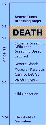

As for what damage can these currents do to a human.... Well, this link HERE will tell you all you need to know about fatal currents and electrical safety. There is also a discussion on what damage can be done in a question asked on this site HERE if you wanted a bit more of a read!

Rule of thumb - anything over 30mA is seriously bad no matter what the voltage.
