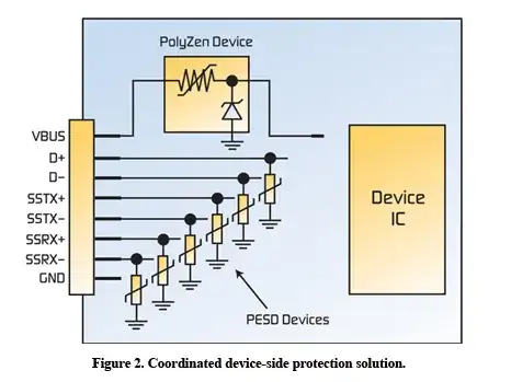

Looks like these are PESD (Polymer ESD) devices, like in this schematic: enter image description here
Here is a datasheet of one of these.
The schematic and explanation can be found here.
