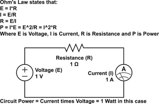

The thing to keep in mind is not only voltage and current in understanding this; you must also calculate power.
Consider this:
schematic
Notice all the circuit values are 1 in the circuit - (1 volt, 1 ohm, 1 amp, and 1 watt). There is no need for a calculator on this circuit since if you apply the value of 1 to any two of the variables in any of those Ohm's law formulas, the mathematical result will always be 1 again.
The power supply is supplying 1 volt @ 1 ampere and is therefore producing 1 watt of power. If the power supply is producing power, then that power mathematically must be being dissipated (in the form of heat) somewhere else in the circuit.
Since current-reading meters, or ammeters, have near-zero resistance, the ammeter is not consuming or dissipating any meaningful amount of power. How do we know this? Let's say the ammeter resistance inside of it is 0.01 ohms (which is reasonable). If the ammeter is passing/showing 1 ampere of current, then the power dissipation (P = I^2*R) = 1 (ampere) squared times 0.01 (ohms) = 0.01 watts. This is a minuscule amount of power dissipation and can safely be ignored in this case.
So, if the ammeter is not dissipating any power, who's left to dissipate the 1 watt of power that the power supply is producing? It must be the resistor. Since the resistor is dissipating that 1 watt of power, and since power is always dissipated in the form of heat, the resistor temperature increases in unison (linearly) with the power that it is having to dissipate.
Now, what happens if we change the Voltage (E) to 2 volts instead of 1 volt? The 1 ohm resistor will now have 2 volts across its leads. (It will be dropping 2 volts.)
Let's do the Ohm's law math now.
Knowns:
  • Circuit Voltage = 2 V
  • Circuit Resistance = 1 ohm (again, ignoring the small ammeter resistance)
  • Circuit Current (I) = E/R = 2 V divided by 1 ohm = 2 amperes
Calculations based on Ohm's law:
  • Power supply is producing: P = I*E = 2 volts * 2 amperes = 4 watts
  • Resistor is dissipating: P = E^2/R = 2 V squared divided by 1 ohm = 4 watts
So as can be seen, if the load (device) resistance remains constant, then an increase in input voltage will cause the circuit power to increase quite a bit. For every doubling of input voltage, the circuit power increases by a factor of four. And remember, the circuit power produced by the power supply mathematically must be being dissipated by the load or device connected to that power supply. (They are equal at all times.)
