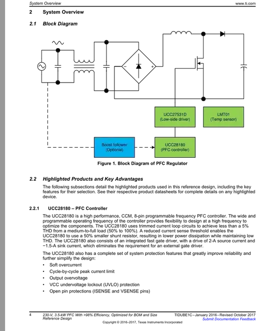

A more ideal solution.
Active Power Factor Correction, for noise immunity to interference to others and acceptable conducted & radiated noise, easily regulated and noise compatible. (good EMC design)

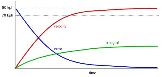

Looking at your code I suspect that your control algorithm isn't good enough. It might be time to look into PI, proportional-integral, control. For an introduction have a look at my answer to Understanding the flow of a PI Controller?.
Figure 2. PI control response for a car cruise control illustration from the linked article.
I'd try setting the proportional band to about 10°C and integral time to 60 s for starters.
