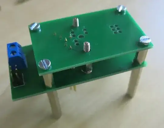

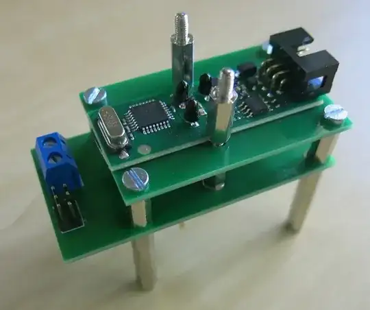

I believe pictures are worth a thousand words (?). I documented my DIY Bed-Of-Nails fixture here: https://piconomix.com/creating-a-good-programming-test-jig-is-not-that-hard/
In short, I create a base PCB with spring-loaded Pogo Pins and an upper deck (mezzanine) PCB with holes that the test PCB locates against. HEX Spacers are used to connect the two levels.
WARNING! Beware of tolerances. If your test pad is small (e.g. 1mm diameter) and one of the pogo pins is off-center (e.g. >0.5mm), then it will not make contact, or worse be intermittent and that will ruin your day.
    +1 Nice work. I like the way you commandeered the standoffs as a simple clamp, though the tolerance on the holes might be a tad sloppy. Over-tightening them might be an issue though. – Trevor_G Feb 28 '18 at 16:00
