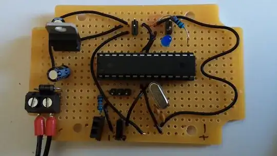

I build a standalone board for my ATMEGA328P-U chip according to this tutorial (which should be the same as this).
My schematic should look like this

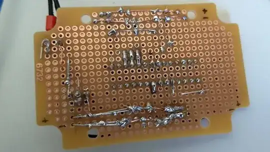

On my real perfboard I have 2 GND lines and 2 5V lines (one pair on each side). I verified that these are 5.02 V.
Pin - Voltage
7 - 5.02V
20 - 5.02V
21 - 5.02V
19 - 0.558V
3 - 1.15V
4 - 1.15V
5 - LOW
All Pins that should connect to GND read a voltage near 0V.

Not shown in the schematic, I use a HC-SR501 PIR motion detector which is connected to Pin 5 (D3). Pin 3 and 4 are connected to a relay.
The setup does work on the breadboard, using power directly from my arduino uno clone.
The standalone board is powered by a 12V, 1.5A power supply.
As you can see, the output voltages are too low. Besides that, the LED is not powered. I uploaded another sketch, that should switch Pin 3 and 4 HIGH for 5s and LOW for 5s.

Ignore the female PIN headers.
I measure 1.15V still. So I assume the chip is not properly working on the breadboard. Any ideas what to check next?

  • @winny 1. Inserted again in my breadboard, the pins still work. 2. Already used it with the breadboard and the relay - works. 3. Noone mentioned it, but I'm aware that the whole board is not the best solder job. @ Ignacio, neat, it's even cheaper than all the diodes. I'll try and get one tomorrow. My plan would be now: Get the ULN, create the circuit on a breadboard with the same power supply and not powered by the uno. Check if the design works per se. And then redo the whole design on a striped perfboard, so I avoid all those bad connections for the power rails. Thank you all so far! – idkfa Feb 25 '18 at 19:21
