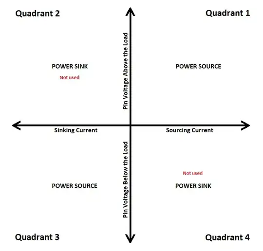

I thought I'd start out with an adaptation of the four-quadrant chart often seen for other reasons in electronics. In the following chart, the \$x\$-axis is for current (into or out of the pin) and the \$y\$-axis is for voltage at the pin (relative to the voltage at the other end of the load that's attached to it.)
There are four possible quadrants. Keep in mind here that I'm discussing digital systems with \$V_\text{CC}\$ (highest possible voltage) and ground (lowest possible voltage.)
  1. In quadrant 1, the pin voltage is being driven above the voltage at the other end of the load and it is sourcing current into the load.
  2. Quadrant 2 is never a good thing for an output pin (and isn't used.)
  3. In quadrant 3, the pin voltage is being driven below the voltage at the other end of the load and it is sinking current from the load.
  4. Quadrant 4 is never a good thing for an output pin (and isn't used.)
Some outputs are only capable of actively operating in quadrant 1 (rarely found, but certainly possible.) Some outputs are only capable of actively operating in quadrant 3 (frequently found and often called "open-drain" or "open-collector" outputs.) Some outputs are capable of actively operating in both quadrants 1 and 3 (quite common.)
For outputs that are capable of actively operating in both quadrants 1 and 3, it's sometimes possible to configure them so they actively operate in only one quadrant, or the other.
I've used the term "actively" to mean that they use an active transistor circuit of some kind. There is another term, "passively," that can be used for simple parts such as a resistor. So, for example, you can take an output that is open-drain (quadrant 3 operation only) and add a sourcing resistor to that pin, tying the other end of the resistor to \$V_\text{CC}\$, in order to provide an "active-LO" and "passive-HI" output. Now, it can both sink and source current! But it cannot source current nearly as well as an output pin that operates actively in both quadrants 1 and 3, because a sourcing resistor is not as good as a sourcing transistor circuit when sourcing current.
So as you can see there are a variety of mechanisms for an output pin. And you can modify output pins that are limited to one quadrant or another, adding a resistor (between the output pin and ground or \$V_\text{CC}\$) to provide a small measure of added behavior in the opposing power sourcing quadrant.

  • This is just so precisely explained which is what I look for. To detail the cases even if they are thought to be obvious or not so important because a beginner like me wouldn't know them. I've a question here, when you said active-LO, you meant current from Vcc through resistor to pin right? and Passive-HI as in current from pin to shunt-LED while one end is sourcing from resistor in parallel to LED, right?
