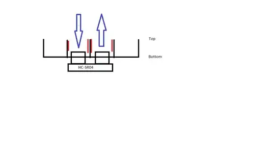

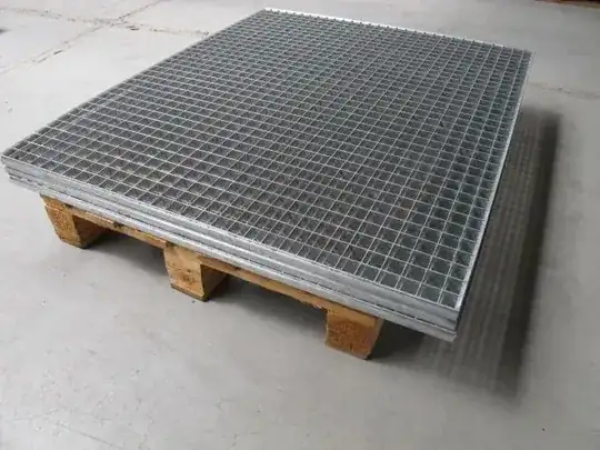

I want to use the ultrasonic sensor under a metal grid plate like below (just 1 of those plates instead of 3). The sender/receiver will be under (partly inside) two adjecent holes (hopefully it fits) and point upwards. The reason is to detect if someone (a person) steps on the plate.
The height of the plate is about 1,5 cm and the height of the receiver/transmitter is about 0,5 cm (if I leave some space for the enclosure), maybe even less space.
In the diagram below I showed hopefully clear enough what I want. Diagram
What I'm worried about is that the receiver picks up the distance to the plate (the red lines), so it will always received just a centimeter or so.

  • Maybe a better diagram would help because I'm not getting what the setup is or what you are trying to achieve. – Andy aka Feb 16 '18 at 11:36
    That looks more like a grid. Aim your sensor through the holes (if it will fit.) The sensor (or the driver software) should have a minimum distance. Below that distance (time, really) it should ignore echos. – JRE Feb 16 '18 at 11:46

This will not work if you stand on it. Ultrasonic sensors have a minimum distance from which they can accept reflections, because the transducers themselves ring, so the circuit has to blank any reflections received while ringing is expected. Even with distinct transmitters and receivers, there's enough electrical and/or acoustical coupling between them that they have to implement blanking.
If you did achieve a minimum distance, you'd still have the problem that the common inexpensive sensors are completely unprotected from moisture, making pointing them up (even indoors) dubious. And no, you can't put a plastic film over them. Weatherproof sensors however are available.
Likely you will have more luck solving this problem with some other technology - light sensors (either passive or emitter/reflector), force sensors, perhaps something capacitive, etc. Or if you want to use ultrasonic, aim it sideways or down from above.

  • Thanks for this insight ... I haven't thought about the moisture problem which indeed can be problematic. Lights might be tricky, I don't like the grid plate movable (unless no other way), force sensors are quite expensive, and ultrasonic from sideways or from above is not realistic since it would 'stick out' the box itself. Accepted because of realizing it will not work (or at least has disadvantages). – Michel Keijzers Feb 16 '18 at 22:42
