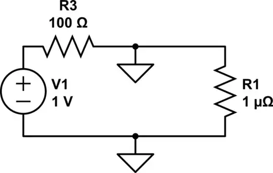

Let's look at the next circuit:
schematic
Will electric current go through R1 in the real world? Is ground like a conductor with some R supposedly > than R1, and can we illustrate this like that :

Yes an no.
As a schematic... No. The ground symbol simply means both those wires are the same node and that node is deemed to be your reference ground for measurements. It is an arbitrary and abstract definition of ground. No current ever flows thorough that point to anywhere.
A ground symbol in a schematic is actually only a special net name designator. The following two schematics are equivalent.
As such, what your schematic is internally represented as in any schematic editor is this. Notice GND is a single node/net that isn't actually connected to anywhere outside the circuit.
schematic
Now you may ask what about trace resistance. Well, if you open that can of worms, whether any current flows through R1 would depend on how you routed the ground net.
This way R1, on the right, would carry a small current...
This way, it wouldn't..

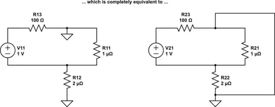

It all depends on what level of reality you are trying to represent in your schematic. The important words here are 'you' and 'represent'. You choose what you mean when you draw a schematic.
Ground symbols represent a connection to the same point, the same node, so they all have the same voltage, exactly 0v, with zero resistance between them. In the first circuit therefore, no current would flow through R1. That's what you've drawn, a short circuit across R1.
If you want to represent a realistic resistance between different points, let's say between multiple connection points to the chassis in a car, then you would show resistors, either between points as in your second diagram, or a resistor in series with each ground symbol. Once you have established what the actual shunt resistance is that you have across R1, then you can work out what the current division is between R1 and the path through ground.
For instance, to redraw your first diagram, showing realistic chassis connection resistances, we might have one of the following. I've drawn it in two completely equivalent ways, as some people don't appear to accept the semantics of multiple ground symbols.
schematic
Here we've designated the Rx1/Rx3 junction as the 'true' ground node, it's the point we reference all our voltage measurements to. I've shown a resistance between the Rx1/Vx1 junction and our ground reference point as Rx2. It might be made up of a physical wire that connects that node to the chassis, together with the resistance of the chassis itself. Now we have shown a finite value for the resistance in shunt with Rx1, we can calculate how current will divide between Rx1 and the groundy path through Rx2. In this case, 33% of the current flows through the ground designators and Rx2, and 67% through Rx1.
I'm sure all will agree that a current flows through R22. I'd be interested to know whether people think a current flows through R12, and if so, where it flows.

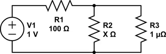

Probably the easiest way to clarify some of your misunderstandings and also bring up some new ideas for you to consider is to see how Spice writes down (to itself) these two schematics:
* TOP SCHEMATIC:
V1 1 0 1
R3 1 0 100
R1 0 0 1u
and,
* BOTTOM SCHEMATIC:
V1 1 0 1
R1 1 2 100
R2 2 0 X
R3 2 0 1u

Now look back up at those schematics as Spice sees them. There are only two different nodes in the first schematic: "0" and "1". But in the second one, there are three nodes: "0" and "1" and "2". All nodes with the same name are connected together (shorted.) If you look closely at the first schematic, you will see that the last line connects both ends of the resistor to the same node, "0". (The value of the resistor is the last word on each line.) Since both ends of the resistor are tied to the same node, this is the same thing as "shorting out the resistor." And so your first circuit simply shorts out \$R_1\$. You might as well just remove it.
