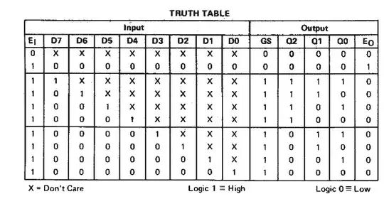

Use a priority encoder like a 74xx148
Or if you prefer CMOS a CD4532

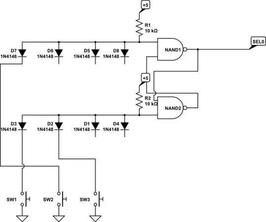

If you want to do it with momentary switches you could do it with a couple of IC packages (flip-flops or cross-coupled gates) to have a 3-bit S-R latch, and then drive the latches on and off with diodes or gates such that pressing any switch will force the 3-bit output to the desired state.
You would need 6 resistors total and 3 diodes per switch, for a total of 24 diodes, or you could use 6 8-input NAND gates cross-coupled and 8 resistors (and no diodes).
Eg. (about 1/3 of circuit partially shown)
