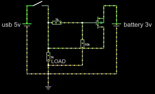

Then I was trying to experiment with a p-channel mosfet, but I'm not sure, if my solution works out in reality. I'm just a maker, not an electronics guy :-( Attached is the schmeatic.

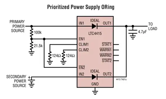

You might be looking for something like this, an ideal diode block: -
It's a little high power for your application but maybe there are lower power types. I'd try reading the data sheet for the LTC4415, getting some keywords then doing some googling. You'll probably find other offerings from Linear Technology and quite possible TI.

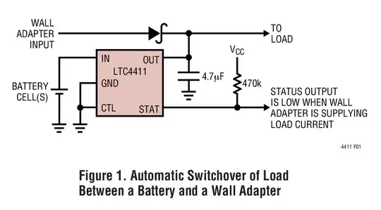

If you can manage to use a schottky on your USB 5 volt rail you could use this (a little cheaper): -

  • Thanks for the suggestions, especially the LTC4411 looks promising. Checking the datasheet and seeing the "Low" Quiescent Current at 40µA totally kills it. The solution is required for a wearable project and right now my circuit is using 700nA during MCU sleep. 40µA would drain the coin cell too fast. – John Feb 02 '18 at 18:42

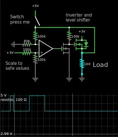

One way of doing it in case you got an op-amp, N-mosfet (or NPN BJT) and P-mosfet laying around is doing something like this:
Here's the link if you want to interact with it.
The scaling is to get the values to safe voltages, not all op-amps can work outside of their voltage supplies, so using a voltage divider will help scale the input to safe intervals. If all the resistors in the voltage dividers would've been 100 kΩ, then the op-amp would have to compare 1.5 V and 1.49 V, this means that any small noise or mismatch of the resistors would incorrectly shut off the 3 V supply. However, using a 80 kΩ resistor instead of a 100 kΩ gives some margin for error, now the op-amp has to compare 1.5 V and 1.33 V. And 1.5 V and 2.22 V when the 5 V is connected.
All in all it's just an op-amp acting as a comparator turning off the 3 V supply, if you are feeding with anything above 3.4 V (because of the 80 kΩ resistor) then the 3 V supply gets shut off, otherwise the 3 V will supply. This mean that if you connect, say, ground or any other voltage that is lower than 3 V to where the 5 V should go, then you got yourself a transistor that will make some magic smoke.
In case you've not noticed it yet, the P-mosfet is upside down, and that is on purpose. If you do choose to make this circuit, make sure you connect the drain and source correctly. The diode in parallel with the P-mosfet is not an actual component, it is the body diode which is a part of the P-mosfet.
The load, which is a resistor in this case, can contain the op-amp in the circuit above.

  • Thank you very much for your circuit suggestion, this looks great and I'm exactly looking for something like that. Just one more question, do you think there is any possibility to accomplish the same result without an op-amp? As I said on the USB rail, a Schottky diode would be tolerable. Thanks! – John Feb 02 '18 at 21:20
    Well, you need to compare voltages in one way or another. If you use an op-amp then you get a stable op-amp acting as a comparator in a small package, if you want to make an op-amp out of several transistors then you can look up how op-amps or comparators look internally. - Without a proper reason for staying away from op-amps, I don't see a proper reason to solve it without it. - To answer your question black on white. Yes I think there is some possibility in accomplishing the same result without an op-amp, by implementing a circuit that mimics an op-amp. – Harry Svensson Feb 02 '18 at 21:24

  • Thank again, I agree, implementing the op-amp circuit in order to use no op-amp doesn't make any sense. :-) Last question, please have a look at this http://tinyurl.com/y9t3w4jn If using a diode on the 5V rail would be ok for me, would this also be an acceptable solution or do you see any disadvantages? Just trying to find the easiest solution which takes up less space on the pcb without voltage drop on the battery rail. Thanks! – John Feb 02 '18 at 21:33
    No that would not be viable at all because your P-mosfet has a body diode, right now it's pointing towards the 3 V supply. This means that current will flow from the 5 V to the 3 V through the body diode and make the mosfet burn up. If you swap the drain and the source of the P-mosfet then you'll be alright. Also I don't see any reason for you to use the 1 kΩ resistor, just remove it. Just do this. – Harry Svensson Feb 02 '18 at 21:39
