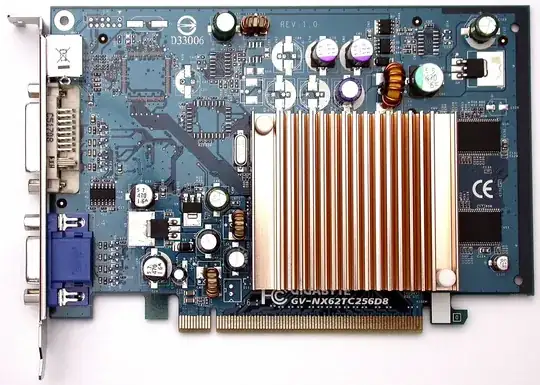

PCI express cards have an edge connector with a little notch in it to prevent the card from moving if the socket is longer than the connector. Additionally, the printed circuit board has a protrusion in front of the actual connector. What is its purpose?
Depicted below is a PCIe card. You can clearly see the protrusion I mean to the left of the edge connector. PCIe card
Picture from Wikimedia Commons by Clemens PFEIFFER, Vienna.

According to the PCI Express Card Electromechanical Specification 1.1 it is to prevent insertion into a standard "non-express" PCI socket.
Excerpt from linked document
http://read.pudn.com/downloads166/ebook/758109/PCI_Express_CEM_1.1.pdf [page 72]
