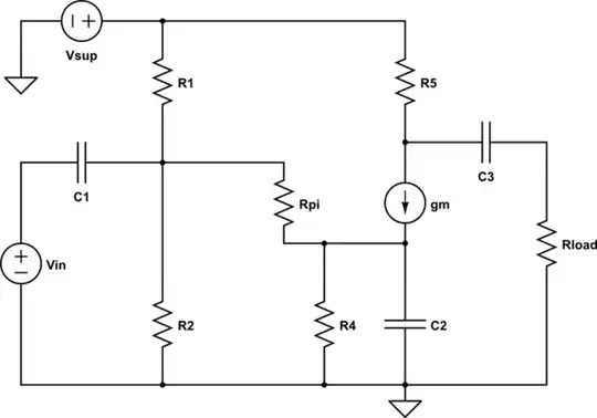

I am investigating a linearised common-emitter circuit of the form:
schematic
I am interested in the isolated transfer functions of each input to the voltage across the load. The power supply to the output takes the form:
$$ H_\mathrm{sup}(j\omega) = \frac{b_3 s^3 + b_2 s_2 + b_1 s}{a_3 s_3 + a_2 s^2 + a_1 s + 1} $$
And for input to output: $$ H_\mathrm{in}(j\omega) = \frac{b_3 s^3 + b_2 s_2}{a_3 s_3 + a_2 s^2 + a_1 s + 1} $$ where all coefficients have been normalised by the constant term \$a_0\$.
From the investigation I have found that for both transfer functions, each coefficient \$a_x\$ (where \$x\$ relates to the power of the Laplace variable) are exactly equal for both transfer functions.
  1. Why is this?
  2. How is it best to illustrate this property, e.g. Signal flow diagram, block diagram, etc. to see why this is the case intuitively?

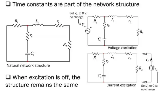

Look at the picture excerpted from a tutorial available here:
You can see that if I turn \$V_{in}\$ off and reduce it to 0 V in the first case or if I turn the current source off in the second case (reduce it to 0 A or open circuit it), the structure of the network always returns to the left-side arrangement: the upper transfer function and the output impedance transfer function in the bottom will share a common denominator.

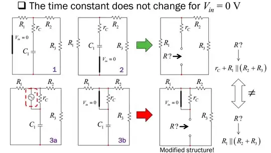

Now, look at the next case:
In the first case, I can determine various transfer functions linking the response voltage collected anywhere to \$V_{in}\$, the network structure is unchanged in this 1st-order system when the stimulus is turned off: all \$D(s)\$ of these transfer functions will be similar. Now, assume in 3a that I inject the excitation signal across \$r_C\$ or I insert a current source (as a stimulus) in series with \$R_1\$, then, you can see that turning these sources to 0 V or 0 A (open circuited), the network does not return to its default natural state: the denominators are not the same.

  • The key element to my understanding of this was that to determine the network structure, both voltage sources are treated as shorts, and thus the topology of the circuit does not change when finding the transfer function of either input to the output. Thank you for the intuitive response! – loudnoises Jan 30 '18 at 07:23
    Do not mix two things: the $V_{cc}$ and the stimulus $V_{in}$: the $V_{cc}$ is an ac short circuit (its voltage is 0 V when you ac-analyze the circuit) and is surely grounded for the analysis. It is when you reduce the stimulus to 0 (0 V or 0 A, short circuited V-source or open circuited A-source) that you reveal the structure. The controlled sources remain in the circuit and are affected by the stimulus reduced to 0. Should you have a controlled source $I=k\times V_{in}$ and $V_{in}=0$, then the source is open circuited. Have a look at the tutorial, there is a lot in it. – Verbal Kint Jan 30 '18 at 07:59
