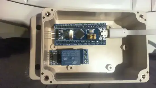

I have an enclosure, and want to fix/put a STM32 inside, a relay and probably later a small circuit board.
However, the STM (STM32F103C8T6) and the relay do not have holes to fix them... and I do not want to glue them because maybe later I want to change/add components.
What is the best way to do this?
Note the USB cable will be get a separate hole to attach (or maybe even a separate connector in the enclosure. The enclosure itself will be attached to a box that will be moved regularly (even during working conditions).

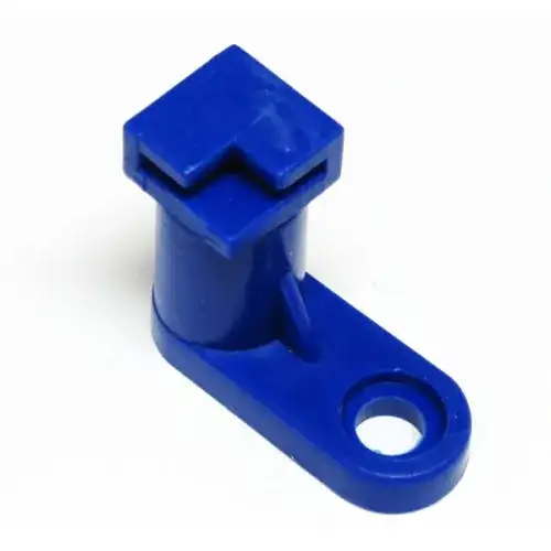

You can buy (or 3d print) fasteners made for such a case. Search PCB mounting feet. These include a standoff to help cooling and prevent shorts.

    excellent suggestion. I'd mount those on another piece of pcb and then fix the whole assembly to the existing studs on the bottom of the case. but OP's relay board is so small and cramped that there is no corner to attach to... – dlatikay Jan 27 '18 at 21:17
  • Thanks, never heard of this (but never done a project, let alone in an enclosure. – Michel Keijzers Jan 28 '18 at 12:52
  • I couldn't find the exact ones, but found one with a 'hole' instead of a corner, which will do too in case I use this method. – Michel Keijzers Jan 29 '18 at 21:03

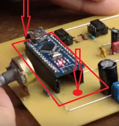

I'd unsolder the four-pin connectors, and use something like this to stack vertically onto a rectangular piece of grid PCB which I'd attach to the four studs on the bottom. Support the side that's not soldered into the lower PCB with two small spacer bolts, and you're good.

  • I'm not sure if there is place in my enclosure to fit it vertically but like the idea. Thanks also for the heat link,, altough it seems a lot of formules to go through. I don't expect that much heat generation. – Michel Keijzers Jan 28 '18 at 12:51

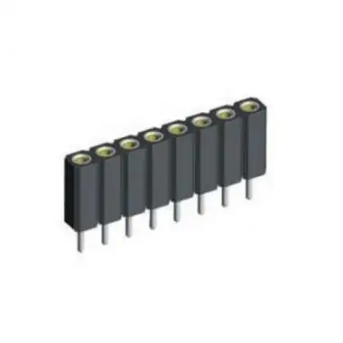

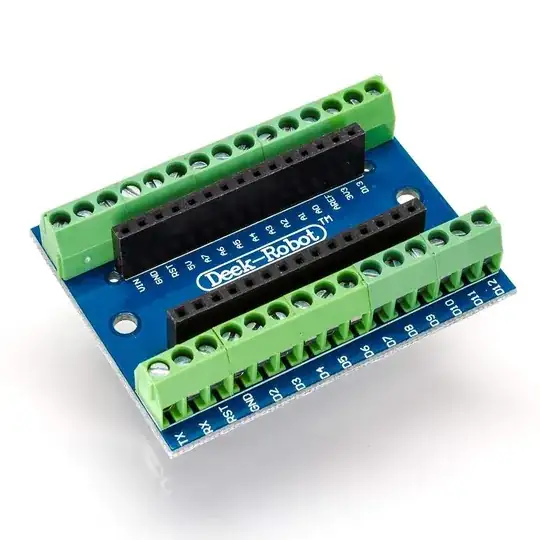

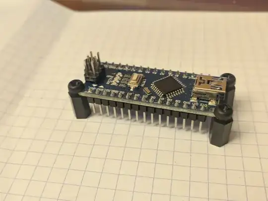

I've mostly used for exactly same applications arduino NANO shields with screwholes or I've made them. Both versions are showed below, but also consider using M3 spacers (M3 is unwritten standard for all electronics) and try to collect some different lenght spacers and different polarities (male-male, male-female, female-female), as they come very helpfull.
PS: Some chinese copies even have holes at the edges holes for M2 or M2.5 sc
And the way, you can make your own from soldering protoboard: just cut as the red line goes and drill the 3mm holes where the arrows show and for the same distance between those 2 holes, another 2 holes int othe plastic case. Below your new "shield", add 8mm (or more) M3 spacers and tighten the shield from both sides. When you solder those black female header pins, you don't need to connect them anywhere, they're there only for holding arduino down. enter image description here
female header pin: enter image description here

  • Sounds like a very good idea, I will check also for the spacers. Thanks – Michel Keijzers Jan 29 '18 at 17:07
    Thanks. Spacers are quite cheap, you can get 100pcs for about 5$ over the web. I'm using 10mm most often (female-female) and in 99.5% of my electronics, I use M3 screws. It's a good way to "standardize" your screws and nuts. That's why I keep about 50-60 different M3 screws (lenghts, heads, materials). – Jakey Jan 29 '18 at 18:55
    thanks ... yes I also going to order a set. This will not be my first project anyway. – Michel Keijzers Jan 29 '18 at 19:49
  • How are those black things called around the pin headers? I think Dupont housing (same like used for dupont cables)? The black surroundings for the pins between the pins of the MC board and the soldering board? – Michel Keijzers Jan 29 '18 at 20:36
    They are called "female header pins". I've corrected my answer to show you photos of them. – Jakey Jan 29 '18 at 21:55
  • Thanks (again)... I should have known, since I have the male version of them. I think it might be worthwhile ordering some female versions as well. – Michel Keijzers Jan 29 '18 at 22:04
    Yes. Also consider buying "extended header pins" in case you will be doing arduino shields for etc. Uno or Mega2560. Shields are stacking one onto another easier. Also you could buy "professional header pins", but I personally don't like to use them. Never did. – Jakey Jan 29 '18 at 22:38
  • Thanks ... actually I started (not this project) using Arduino's, however, I soon found out the Arduino's are too 'light', and found the STMs which have better specs (and cheaper). But maybe I might use some kind of STM shields so that's a good idea. – Michel Keijzers Jan 29 '18 at 23:12
  • Doesn't matter. If only needed to play with 1 relay - it doesn't matter what you use. Nowadays electronics is so cheap, it doesn't matter which company you pay for uC. – Jakey Jan 29 '18 at 23:58
  • True :-) ... eventually it will be part of a bigger system (if I ever can find the time), than I need to add DMX (output), nRF24L01 (or another RF device). – Michel Keijzers Jan 30 '18 at 00:21

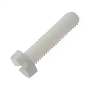

Yet another option is to use plastic screws or fasteners:
Drill holes outside the area occupied by the module, then fasten the screws to hold it firmly in place. Unscrew when you want to remove/replace a module.
