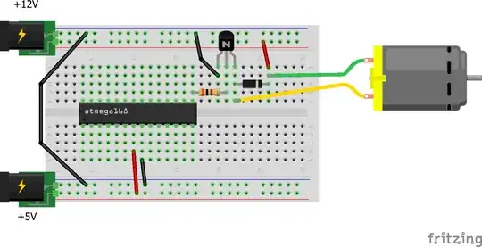

I am controlling a DC fan by an AVR MCU and I am curious about the thermal characteristics of a 2N3904 NPN transistor over which the fan is connected.
The circuit

    ^+1, but I don't understand your reasoning for the 'case-to-ambient' thermal resistance. Power is dissipated at the junction and you are measuring at the case, so you should use the R_j-c value in your calculation. The case heats up 83.3C per Watt dissipated in the junction. – vofa Jan 27 '18 at 00:33
    Although not related to your question, FYI the wiring diagram shows there are missing requirements for reliable ATmega operation e.g. missing $\small AV_{CC}$ connection to pin 20 (even when the ADC isn't used), missing Gnd connection to pin 22 (both Gnd connections should be used), missing decoupling capacitor close to the MCU etc. All of those missing details could cause unreliable operation depending on other factors e.g. GPIO current requirements for external sink/source, noise on the incoming power rail, etc. etc. Read the MCU datasheets & research "breadboard Arduino" for more info. – SamGibson Jan 27 '18 at 01:23

    @SamGibson The figure above is very simplified. I am actually using ATmega32 with a couple of temperature sensors, couple of fans, serial communication, etc. But all of this would bring in the noise in this question. I already have decoupling caps, as well as analog noise cancelling. Thank you for the comment, though. – Nikola Malešević Jan 27 '18 at 15:34
