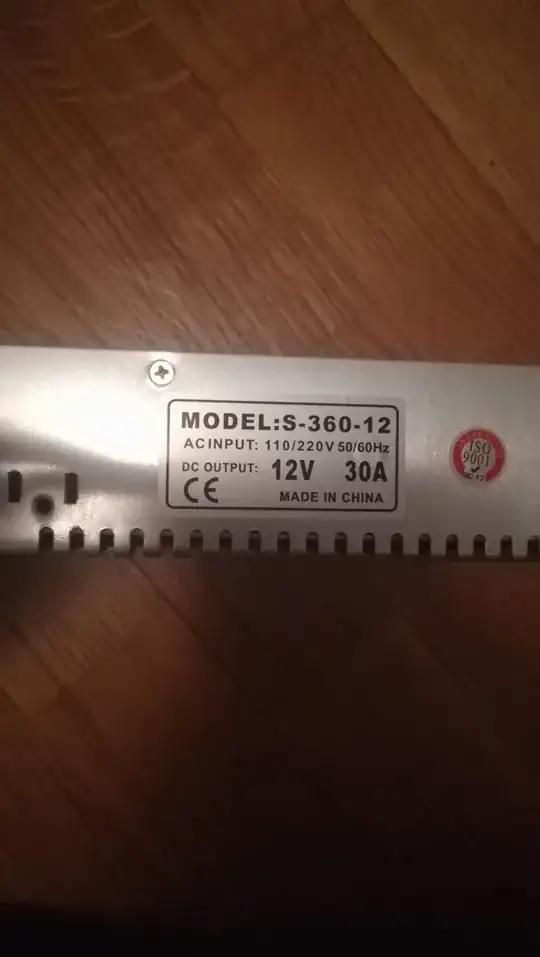

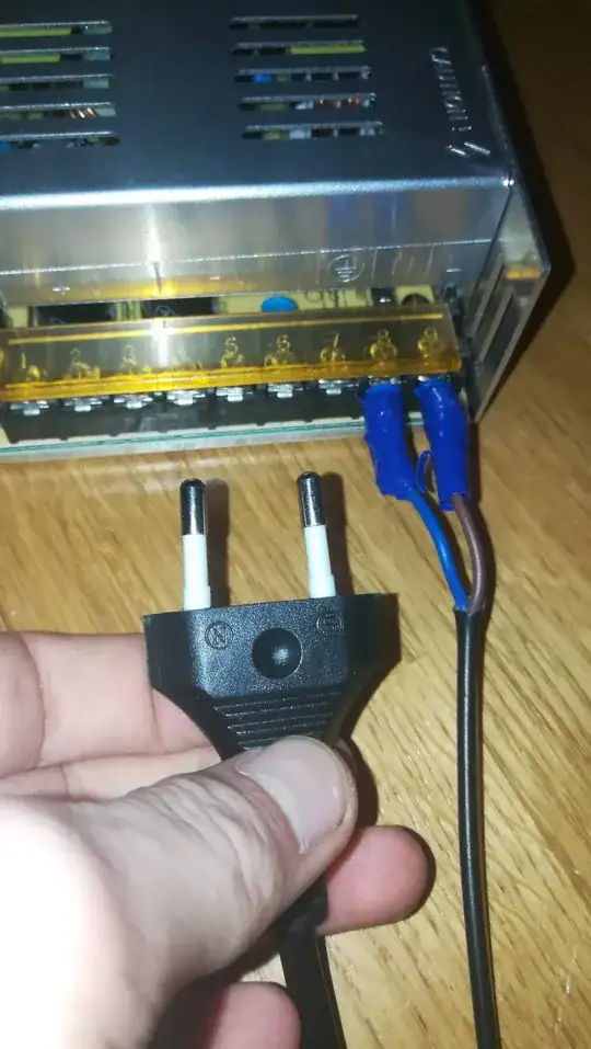

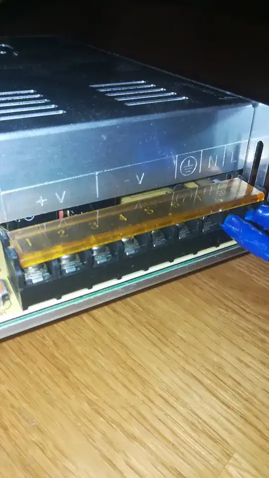

I have a 12 V regulated power supply that I use for a car audio amplifier in my home and I only have it hooked up with a cord that has a line and a neutral, no ground. Could this be dangerous or cause any other issues? It's been working fine so far and I don't get a shock when I touch the case of the power supply.
3Is the 12V supply double-insulated? (Does it have the double-insulated symbol, a square box inside another one, on its label?) Double insulation is the standard way to ensure safety without a ground. – Jan 23 '18 at 21:08
Helpful: Why don't we use neutral wire for to ground devices and earth wire for closing the circuit? – Jan 23 '18 at 21:14
Can you post pictures of the power supply and cable you're talking about? – vofa Jan 23 '18 at 21:17
2 Answers
Quite simply, they provide an earth connection so it requires connecting to earth.
The safety earth is there to protect you, and also the equipment, in the event of a fault that connects a dangerous voltage to the chassis and metalwork.
The fact that no such fault has happened so far does not stop it happening in the future. On the day it happens, if at all, you'll need the safety earth. The consequences of not having it range from pain to serious harm to death.
Take no pointless or easily-avoidable chances. Use a proper mains cable with earth and change the risk from unlikely or improbable to nigh-on impossible.
It's a good lifelong habit to adopt and will cost you all of about £2 for a cable.
