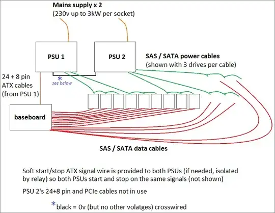

(OP updated: image added as recommended by comments/replies)
Electrically it looks simple enough. Give them both the same shared "soft start/stop" feed, and crosswire 0v to give them a common ground plane. I'd have a stability advantage over the mining users in that I don't want extra power for PCIe graphics cards, my need is extra 5v/12v power with a common ground plane just for external HDDs. So I'd have one PSU handling the baseboard and 1/3 of the HDDs, and the other PSU handling the other 2/3 HDDs.
Parallel PSU also beats a larger monolithic PSU in other ways that benefit me: I need disproportionate 5v, more than even a 1600W PSU would provide (5v @ up to 36A needed for HDDs but not used by PCIe/graphics cards which large PSUs target, so max on even a 1600W PSU is about 24-30A while dual gets me 48A). It doubles my HDD connector sockets so I can reduce current/heating in any given string (5-6 HDD connections per PSU, so only half the number of HDDs on each). It also spreads heat dispersal between them. I don't have resources for a formal dual-PSU case of the kind I'd need, so it's either dual high quality standalone PSU or large PSU. So I'd like to do it if I can.
In theory I'm guessing there shouldn't be much scope for problems due to current loops. Also, unlike wiring in series (see this question), their 0v planes would be connected so even if both PSUs were earthed, I guess the earth would be in common for both anyway, which might help avoid earth loop issues.
In theory, provided it works electrically, I use very high quality PSUs from the same brand/model range (which I would), and I double check the crosswiring and junctions on any crosswiring cable before using it, dual PSU is a far more efficient solution, gives several electrical benefits, and costs 1/4 the price of a monolithic 1600W PSU while guaranteeing that both 5v and 12v peak current capability are met.

  • PlasmaHH , marcelm - added a wiring diagram in the OP. – Stilez Jan 23 '18 at 18:04

If in doubt don't parallel them - it could end messy. However, you should be able to split the load into two halves and use one supply for about 50% of devices and the other supply for the remainder. You should cross-tie the 0 volt ends of the two power supplies as well.

  • I've added a diagram to the OP, does this help to clarify? I think it's roughly what you are describing. – Stilez Jan 23 '18 at 18:12
  • Yes this is what I'm suggesting but please make it clear in your question that this is an edit following recommendations so that people don't think I'm just reiterating (in my answer) what you said (ostensibily) originally in your question. – Andy aka Jan 23 '18 at 18:22
  • Done - added a note under it – Stilez Jan 23 '18 at 18:29

  • I've added a diagram to the OP, does this help to clarify? I think it's roughly what you are describing – Stilez Jan 23 '18 at 18:14
  • I found their design for it (under "pod 1", thanks for the link!). But they don't discuss the electrical side of having 2 PSUs as asked in the OP. For that, I think this place is better to ask. Backblaze's post (as well as many mining posts) certainly helps to confirm it's doable - but they may have magic or grounding I know not of! – Stilez Jan 23 '18 at 18:33
