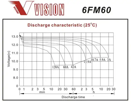

Here are some typical discharge curves for AGM lead-acid, in this a case a 12V 60AH battery (40Ah should be similar but with all currents multiplied by 40/60):-
Note that the time scale on this graph is logarithmic so the curves are a bit deceptive. However you can see that as current increases voltage reduces, and capacity is reduced at high current (eg. at 60A it lasts 30 minutes which is only 30Ah). So you can use voltage to estimate remaining capacity, but to get reasonable accuracy the effect of current draw must be factored into your calculations.

Capacity loss may occur suddenly and cannot be reliably predicted, so to get the actual capacity you need to measure it. The obvious method is to fully charge the battery and then discharge it until empty. Alternatively you could just discharge until you reach the minimum working voltage in your system at normal current draw, as this is the effective capacity in your application. If only done occasionally this calibration cycle should not significantly affect lifespan.

  • The curves are not actually logarithmic, they just look that way because only one axis is logarithmic. Voltage drop during discharge is relatively linear until the battery is almost flat, so a linear extrapolation may be good enough. The effect of current draw can be included by modeling internal resistance and adjusting capacity to match the known battery characteristics (if you don't have data for your battery then use the graph above). How complicated it gets depends on what accuracy you want - many would be happy with 5 'bars' showing approximate percentage of charge remaining. – Bruce Abbott Jan 23 '18 at 07:13
