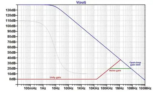

Below is a picture of the open-loop gain of a fast op-amp. The open loop gain is in blue: -
In red is the resulting TIA gain non-inverting voltage gain; it begins at low frequencies at a value of 1 (0 dB) and at 15.9 kHz starts to rise at 20 dB/decade as the photodiode self-capacitance starts to have an effect. The green line I have shown is the effect of adding a feedback capacitor - it reduces the noise gain of the circuit.
So, if you want a reasonably clean waveform from your photodiode amplifier you have to counter the effect of what is called "noise-gain" and this means slugging the response significantly. Remember the added capacitor only attempts to clean the noise from the circuit but every pF added directly slugs the main signal from the photodiode.

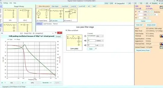

The photodiode limits the bandwidth, because the opamp has to suck the photonic charge out of the photodiode, thru the feedback resistor.
The photodiode capacitance, and the feedback resistor, form an RC LowPassFilter, which provides additional phaseshift into the loop stability behavior.
Result? instability, peaking, ringing, oscillation. As shown below.
Here is a timewaveform of TIA with 750pF on the "virtual ground" node.
