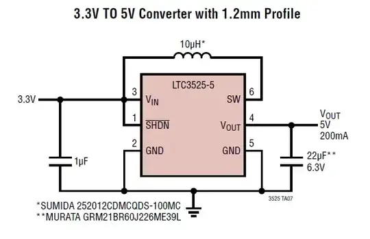

As this site is about designs I would recommend the circuit below for a small, 200 mA, 5 volt output from an input of 3.3 volts: -
If you want more power out then there are plenty of boost converters that can deliver amps at the output.
All the usual vendors (like TI etc.) can provide similar offerings and both Linear technology and TI have very good search engines that allow you to enter input parameters and get recommendations of suitable devices.

  • I know this is from 3 years ago, but I am thinking of using this circuit in my own project. I noticed you used a capacitor on the pin SHDN instead of a square wave input like many other diagrams including the example schematic that the datasheet suggests. How does this work? – Artichoke Jun 08 '21 at 08:37
  • I didn't fully read the datasheet, the same schematic, in fact is in it. – Artichoke Jun 08 '21 at 08:46
  • The SHDN input is tied to the incoming 3.3 volt supply. If you need a shutdown facility then it should be detailed in the data sheet. – Andy aka Jun 08 '21 at 09:46
