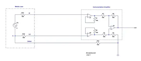

Below is a floating source is coupled to a instrumentation amplifier via a twisted shielded cable:

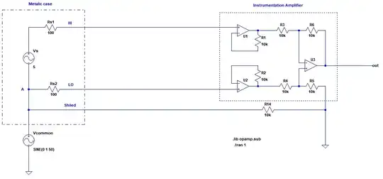

For the sake of showing effects to some people by simulation, I want to add a common mode voltage, a magnetic coupling effect and capacitive coupling effect to the cable to mimic the real scenario. So far I tried to add a common mode as below:
How can the final circuit be modified so that magnetic and capacities coupling also demonstrated?

  • Thanks for the answer I will try these. But there is two things maybe you might comment on: 1-) At least is my model for common mode voltage correct? If so I will keep it. 2-) As you see the amplifier is an inAmp and as far as I underatnd since the inAmp has huge input impedance output resistances need not to be equal becuase source to ground resistance for each line is dominated by the buffers of the inAmp. If correct why is twisted cable used. If the line impedance are dominated by the inAmp and we dont care about the source impedance why we care about twistng? – GNZ Jan 19 '18 at 10:59
  • Thats why I want to simulate and see if magnetic imbalance has effect on the output. – GNZ Jan 19 '18 at 10:59
  • your model is fine. 2) You need to model line capacitance so you should use maybe 50 - 100 pF per metre lumped and these will dominate over InAmp input impedance. 3) Twists are used to cancel out a magnetic field trying to impegnate the cable; in effect the only net induced voltage is that over the area bounded by one twist. This is a big subject and well beyond the scope of the original question and there are plenty of answers to this on this site.

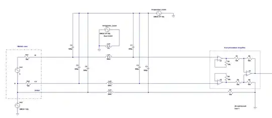

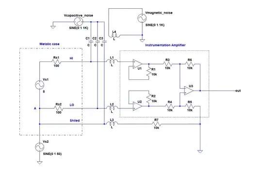

  • Please also see my edit. I tried to draw what you mentioned as lumped model for the magnetic and cap coupling. C1 C2 C3 are for cap coupling. L1 L2 L3 are coupled via L4. Is this better? – GNZ Jan 19 '18 at 12:11
  • I'd put the capacitors after the inductors i.e. on the InAmp side. In fact I might split them either side of the inductors to make individual pi networks per conductor. Other than that it looks ok. – Andy aka Jan 19 '18 at 12:19
  • Is this what you mean right?: https://i.stack.imgur.com/7yMVG.png – GNZ Jan 19 '18 at 12:38
  • Check that circuit - you appear to have shorts in some places that are unintended. – Andy aka Jan 19 '18 at 12:51
  • Please help could you make a drawing for that pi or capacitive wiring part? I found the shorts but then the circuit doesnt make sense. – GNZ Jan 19 '18 at 13:24
  • Your first attempt at adding capacitors is closest and correct - just move the lower terminals on each of C1, C2 and C3 to after their respective inductors. I have no idea what went wrong during the drawing process in your final schematic. I get these sorts of moments now and then but I put it down to my age LOL. – Andy aka Jan 19 '18 at 13:29

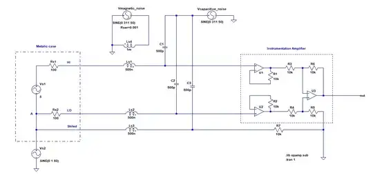

  • Im not sure but maybe you mean this https://i.stack.imgur.com/wOLUs.png ? – GNZ Jan 19 '18 at 13:45
  • Yes that looks right and, when you have done some evaluation on this, you can think about applying capacitors to both sides of each added inductor to form a pi network. That means 6 capacitors in total being fed from Vcapacitive_noise. – Andy aka Jan 19 '18 at 13:54

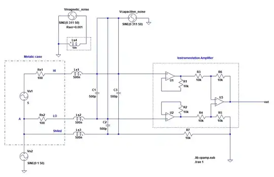

  • My last chance and attempt: https://i.stack.imgur.com/ITHEE.png ? – GNZ Jan 19 '18 at 14:06
  • Correct but now each capacitor is half the value for the same line length. – Andy aka Jan 19 '18 at 14:12
