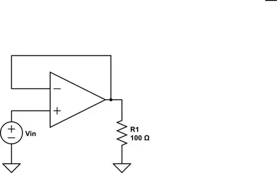

There are circuits for constant controlled voltage, and constant controlled current as shown below:
Voltage controlled constant current source
Voltage controlled constant voltage source
schematic

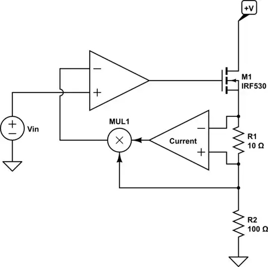

What if I wanted to create a circuit that was a voltage controlled constant power source? Here is the basic idea, I'm wondering if anyone has used a circuit that does this sort of thing, or if there are circuits that do this. I have not found any yet. I would like to control the power going into a load.

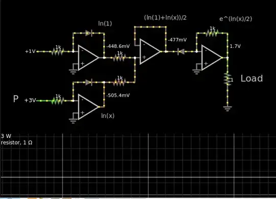

One way of doing it would be to use diodes since they have logarithmic properties.
We also know that \$P=V^2/R\$, and we also know that R will be constant (just a resistor, right?), then we can normalize our expression along these lines, \$R=1Ω\$.
This means that we can go further with this expression:
$$ \begin{align} P&=V^2/1Ω\\ P&=V^2\\ \sqrt P&=V\\ P^{1/2}&=V\\ e^{\ln(P^{1/2})}&=V\\ e^{\ln(P)/2}&=V\\ e^{(\ln(1)+\ln(P))/2}&=V\\ \\\text{Rename variables..}\\ V_{out}&=e^{(\ln(1)+\ln(V_{ref}))/2}\ \end{align} $$
Alright, we can go between \$e^x\$ and \$\ln(x)\$ with diodes, resistors and op-amps. I want to keep this answer short and concise, so rather than going in to how everything works I will show you the end result with voltages and you will hopefully be able to see how and why everything works.
Here's the link in case you want to mess around, say... change the number 3. Just scroll with your mouse button when it is over the number, or go to the right hand side and change the red "Voltage" slider.
The problem with this setup is the fact that the diodes have to be matched, well, you can always do some compensating with some resistors.. so it's not impossible, but it can be done purely in the analog domain.

    You could use the base-emitter junctions in a matched transistor array instead of trying to do your own matching. – vofa Jan 17 '18 at 03:16
  • @vofa Hmm I was thinking about that, but I'm not 100% sure if they are entirely logarithmic like diodes. I know that the $V_{BE}$ behaves like a diode ($V_{forward}$), but I believe you mean that I should replace the diodes in the schematic above with NPN transistors that has their base shorted to their collector, right? - But hmm, the extra current that comes from the collector.. I'm not energetic enough to verify ifthe current is all logarithmic or if there is some linear term added in there. - But why can't I just use didoes in a matched diode array? – Harry Svensson Jan 17 '18 at 03:35
    Seems to work fine - http://tinyurl.com/yc343lk8 . Quad matched NPN arrays are commercially available. I have not seen quad matched diodes. – vofa Jan 17 '18 at 03:44
  • @vofa Huh, cool. Did not know that. - Ah okay, so that's why quad matched BJT is preferred, makes sense. – Harry Svensson Jan 17 '18 at 04:04
    How does this not have more upvotes? Very, very clever! – testname123 Jan 17 '18 at 07:37
  • If you do not care about last stage anti-log, than tiny dual PMP4201 or DMMT3904W will fit perfectly. – kimstik Sep 09 '19 at 16:11
  • I do not see need of anti-log in case of closed loop of original topic – kimstik Sep 09 '19 at 16:58
    @kimstik then make an answer skipping the anti-log and use closed loop instead. I'd love to see it. Show a schematic like I did. Remember, the goal is to make a function that takes a voltage in and spits out the sqrt of that voltage. - Because that's what setting a desired power in voltage -> the voltage across the load. – Harry Svensson Sep 10 '19 at 03:57

Your circuit looks conceptually okay, concerns would include the input voltage range of the instrumentation amplifier and its common-mode rejection. Stability is the most likely thing to cause headaches in many of these circuits.

It is certainly possible to design a constant power source, and the schematic you posted is one approach, discussed for example here
I see in the comments that you need > 100Hz of bandwidth. Depending on the nature of the load, and range of output power if adjustable, you may have some difficulty stabilizing the loop. If the load is resistive, for example, there is highly non-linear transfer function from the output voltage (or current) to the sampled variable - i.e. the output power. That means loop gain will vary based on operating point. The problem is not intractable, though, especially if you have a well characterized load and don't need to operate over a large range of output powers.
