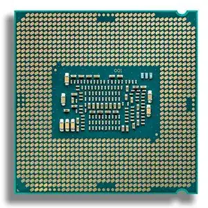

cpu underside
There are many connection pads. Clearly they act as lots of micro heat sinks that transfer some significant proportion of the heat to the socket /PCB. Indeed many surface mounted components dissipate heat through (via stitched) copper layers.
So if cooling is important (as for the CPU overclocking community), why aren't CPUs cooled from beneath the PCB as well, with say a fan?

I'm certain Intel and AMD wouldn't put these passives on the bottom of their CPUs if they could avoid it. In fact, look at that picture: the green board you're looking at is not the die, it's the PCB carrier that the board is connected to; that's the technological price you pay for being able to cheaply mass-produce interchangeable CPUs rather than just having motherboards with the CPUs Chip-scale-package ball soldered onto them directly – and you can't completely have that, even theoretically, because the heat from that CPU is just so much that a heat spreading metal plane has to be pressure-fit on top of it, and you can effectively only do mechanically that by having the die on some sort of substrate.

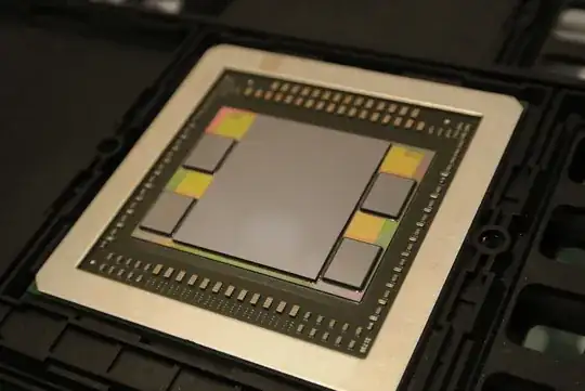

    Note that the image is of AMD's Fiji GPU, used in the R9 Fury series. The silicon interposer it uses is a rarity, even among multi-chip packages. Most simply put all the chips on the FR4 substrate, but Fiji's four stacks of High Bandwidth Memory required silicon to provide the necessary wire density for a 1024 bit bus to each stack. – 8bittree Jan 16 '18 at 18:27

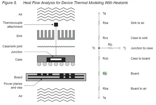

In avionics, cooling is evaluated for all possible paths, including via the PCB.
A mainstream microprocessor in a laptop / desktop generally uses a mixture of conduction (heat sink) and convection (forced air usually) cooling. As the mixture of these two moves the majority of the heat away, the cooling mechanism via the PCB is sometimes ignored, but it is still present.
If equipment is in an unpressurised avionics bay, convection cooling rather loses meaning (the air density is very low meaning that there are insufficient molecules at high altitude to spread the heat). For that reason, conduction cooling is very widely used as it is the only truly effective cooling method in this scenario.
For this to be effective, numerous planes are used within the PCB as heat spreaders.
Where heat sinks are used (not a preferred solution but sometimes unavoidable), the path is still conduction cooled via heat ladders to a cold wall (this is a relative term - the cold wall may be at 70C or more).
Forced air is sometimes used, but within a pressurised chamber attached to the cold plate.
So in this scenario, cooling via all paths is utilised; conduction from both sides, FR-4 may not be particularly thermally conductive, but the copper planes are.
I went into a somewhat detailed thermal discussion in an answer to this question.
