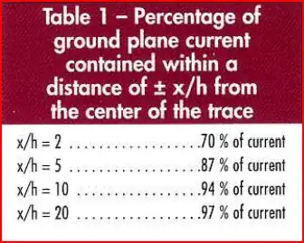

According to the figure below, you can see (for high speed signals) most of the return current flows very close to the trace (x is distance from centre of trace, h is trace height above plane):
Current Flow
No time to go into more detail right now (will try and add more later) but here are a couple of excellent links on the subject:
