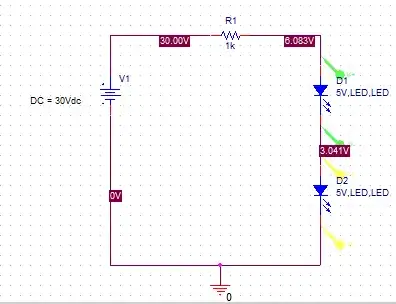

I simulated a basic circuit in Orcad but I don't know how it found voltages(6.08 V and 3.04 V) on the nodes? How do I calculate those voltages mathematically? I am attaching three image files of schematics and values.
NOTE: Current value in circuit is 23.92mA according to OrCAD calculations.
This is schematic diagram with values

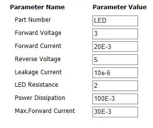

These are LED values

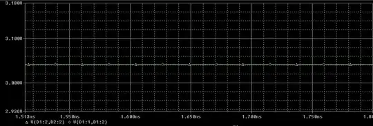

These is the voltage across both LEDs

  • Your question provides only the simplest possible model for the LED: $V_D=2.96:\text{V}+2:\Omega\cdot I_D$ or else $V_D=3:\text{V}+2:\Omega\cdot I_D$ depending on how I interpret what you provided. Trivial algebra, either way, but of very limited use. A more general solution would use the Shockley equation of the diode, but it also requires model parameters that cannot be derived from the information you provide. And I don't know which was used by your simulator. Can you add anything here before I try and answer? – jonk Jan 10 '18 at 02:40

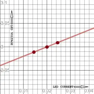

The above model is based upon the following idea. Suppose you take three measurements with the LED, getting both the voltage across the LED as well as the current through the LED, and place them onto a chart:
If you then use a ruler and draw a line through the points, you may find that it intersects the y-axis at some value. In the above case, it intersects right at \$V_{FWD}=2.96\:\text{V}\$. This is the meaning of \$V_{FWD}\$ in the above model. It's a projected value based upon an extrapolation from a few actual points made elsewhere on the chart. Similarly, the slope of the line, in this case with \$R_{ON}=2\:\Omega\$, provides the other model parameter. (You can compute these from a collection of raw data points by using a "least squares fitting" algorithm for lines, if needed.)
A circuit with a power supply of \$V=30\:\text{V}\$, a resistor of \$R=1\:\text{k}\Omega\$, and two added LEDs (all of these in series), yields the following result (the \$2\$ comes from the fact that there are two LEDs in series):
$$30\:\text{V} - I_D\cdot R - 2\cdot \left(V_{FWD}+R_{ON}\cdot I_D\right) = 0\:\text{V}$$
That equation is easily solved for \$I_D\$:
$$I_D=\frac{30\:\text{V} - 2\cdot V_{FWD}}{R+2\cdot R_{ON}}$$
(You should be able to solve and find the above equation.)
Using your table of LED information, I may get either of these two models and their predictions:
  1. \$V_{FWD}=2.96\:\textrm{V}\$ and \$R_{ON}=2\:\Omega\$, \$\therefore I_D=\frac{30\:\text{V} - 2\cdot 2.96\:\textrm{V}}{1\:\text{k}\Omega+2\cdot 2\:\Omega}\approx 23.98\:\text{mA}\$
  2. \$V_{FWD}=3.00\:\textrm{V}\$ and \$R_{ON}=2\:\Omega\$, \$\therefore I_D=\frac{30\:\text{V} - 2\cdot 3.00\:\textrm{V}}{1\:\text{k}\Omega+2\cdot 2\:\Omega}\approx 23.90\:\text{mA}\$
Neither of those are an exact match with the value you provided. But they are very close. The fact that they are not exact suggests that either I didn't interpret the table you provided correctly, or else a different type of LED model was applied in simulation.

  • Ok. The specification of LED which I have attached as the second image is the data and there is no strong reason to use the 1k resistor but just messing with OrCAD and trying to simulate circuits and I stumbled across this question in my mind that how OrCAD determined the value of node voltage (like 3.04V)? Then, I tried it to accomplish with some math but failed because maybe I don't know which equation to use! – APX100 Jan 10 '18 at 02:22
