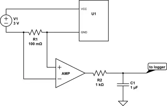

I could place a multimeter in series, but even if it has data logging, that is at some interval and I'd have to interpolate, and could entirely miss variations smaller than the interval.
So, you can put a low-pass filter in your measurement chain to log the mean value at a reasonably low frequency:
schematic

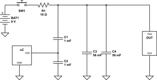

All these answers and only @wbeaty mentioned the obvious one. A device that integrates current with time? What about I = C dV/dt?
If the current consumption is low enough, a few capacitors might be more than enough but a super capacitor would be needed for higher currents. Adjusting the capacitors to obtain a reasonable drop in a reasonable amount of time. A circuit like the one below would do the trick.
schematic
The capacitive divider is there to avoid removing current from the node. It can be pre-charged to the supply of the uC via the peripheral pin to establish the initial condition, and then periodically measured to read the rate of discharge. One problem with this circuit is that the output voltage will change, which could mean a variable load.
To avoid this problem, and for an adjustable all-purpose circuit with reasonable size components, an active capacitance multiplier could be used instead, like the conceptual schematic below. Some calibration with known loads, and you have a custom-made consumption-meter.
schematic
