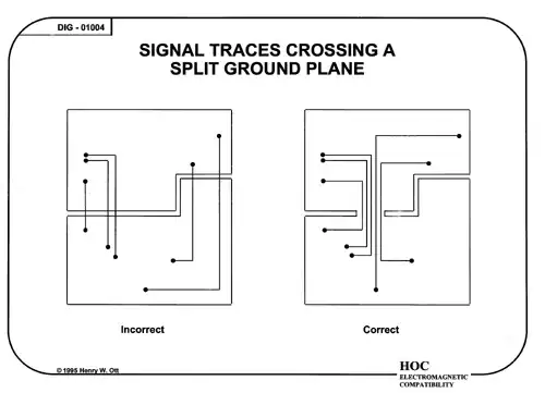

It really depends on your design. Henry Ott says it will simplify your design in general.
Off the top of my head there are a few reasons you don't want split planes:
1) It turns your board into a dipole antenna
2) Crossing a split plane with a trace is bad because it increases inductance and complicates the paths for return currents.
There are reasons for splitting planes, in some cases it can reduce common mode noise or noise on the analog side of the ground plane. If your isolating your analog section completely (which I would not recommend, but is sometimes necessary) then you will need split planes.

  • Yeah I have seen this image before just gets confusing when half of the manafacturers reccomend split planes! If you have any advice on how to layout the power plane using this method it would be greatly appreciated! – Revilo Engineering Jan 09 '18 at 14:05
  • Like I said in the post, it is completely design dependent – Voltage Spike Jan 09 '18 at 16:21
