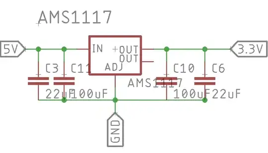

Also, in some websites I did find schemas with 2 capacitors on INPUT and 2 on OUPUT, on parallel, both of 22uF + 100uF.

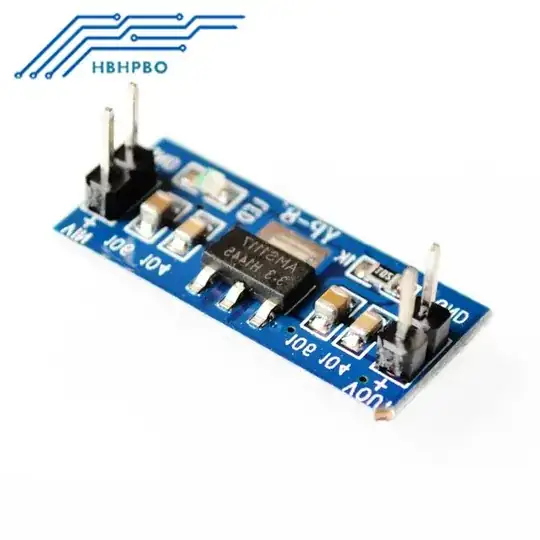

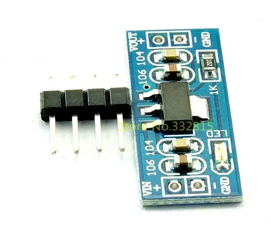

Edit: another schematic with this AMS1117 is the module provided on Aliexpress.
This is the image (mirrored...), you can read 104+106 on input and same on output.
I did test them from a friend and seems to work... What do you think about them?
On another image, seems clear that 104+106 on input and 104+106 on output. Is possible that supplier does not respect the datasheet?

  • OK... I will remain with electrolytics capacitors. Thank you in advance, what about my second question (2 capacitors on input 2 on output?) – sineverba Jan 02 '18 at 19:43
  • Generally adding capacitors to the output will improve load regulation. But I don't see what you're asking specifically; all you asked is "Is it an exageration?" but I don't know what you're referring to or why you think it might be an exaggeration. – The Photon Jan 02 '18 at 19:46
  • I'm referring to the double capacitors on input and output. Btw, I did update the question with another module just find on internet and tested from a friend of mine. What do you think? – sineverba Jan 02 '18 at 22:56
  • But why do you think it's an exaggeration? How does that even make sense? (Exaggeration means you say something is more extreme than it actually is like "your car is as big as a yacht") – The Photon Jan 02 '18 at 22:57
seems ok . its simple to understand why that one have a 100uf ceramic capacitor. because in the datasheet it asks for a tantalum 22uf so as the designer is using ceramics ones that are cheaper but not that good, so, he added a 100uf one just to be sure , making it over specified. so, he compensate the lower quality parts by using way bigger value. the thing is 22+100 uf in ceramics is better than the 22uf tantalum alone and they are still way cheaper than using the tantalum.
for coincidence i'm planning to do exactly this in some circuits here with the ams1117, i saw that in the datasheet these days and after searching for the capacitor prices i decided to use bigger ceramic or electrolytic ones. well, i can post later here if i encounter any problems or unexpected things
