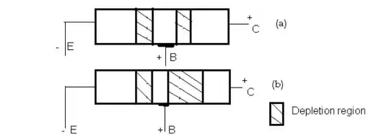

Indeed it has to do with influence of Vce on the Base region. A higher Vce increases the size of the Base-Collector depletion region. This depletion region partly expands into the Base region making it smaller.
See this illustration, (a) shows the transistor in forward mode with a certain Vce. (b) shows the same but with a higher Vce.
This results in a smaller Base region and an increase in current.

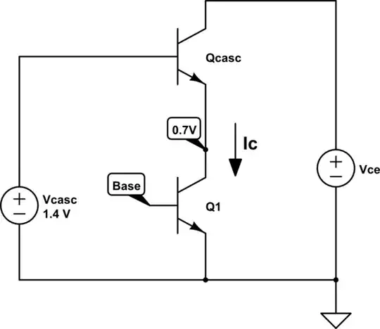

Like cascoding:
schematic
Here Qcasc takes care of most of the Vce so it will suffer from the Early effect. However, Qcasc does not set Ic, Ic is set by Q1 and Q1 has a nice fixed Vce of around 0.7 V.
A disadvantage of cascoding is that the minimum Vce will be larger than using only Q1 of course so cascoding is not always an option.
An advantage of cascoding is that the Miller effect become much less dominant as the voltage gain from the base to the collector of Q1 is only about 1 (one). For high frequency (RF) amplifiers this advantage might be the only reason why cascoding is done. Then the Early effect isn't really a problem but the bandwith of Q1 is. Cascoding is needed to get and use the full available bandwith.
