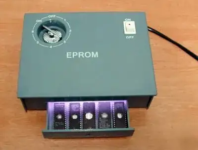

UV-EPROMS can only be erased by exposure to UV light so EPROM erasers were manufactured for this purpose. These erasers contained one or more UV tubes and a timer. EPROMS were placed in a drawer which was then closed and the timer set for 20 or 30 minutes, after which time the devices were completely erased. It was not possible to erase them electrically using a device programmer.
EPROM Eraser
These days, EPROMS are rarely used since electrically eraseable technologies have almost entirely replaced UV eraseable PROMS.
