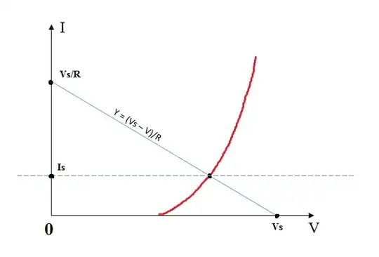

Since the forward voltage of the diode varies slightly according to the current through it, more accurate value of the current can be found out by -
  • Plot forward V-I chara of the LED (from its datasheet).
  • Plot the load line of the series Resistor for the given value of R.
  • Find the meeting point of the two graphs. It should be the operating point of the LED + series resistor circuit. enter image description here
Vs - Power supply voltage.
V,I - Forward voltage and current through the LED.
Is - Current through the LED for the given series resistor R.

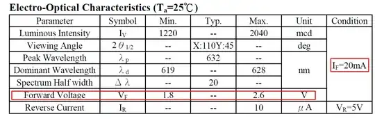

If you look at the spec sheet for a typical LED you will see something like this.
Notice the test condition of 20mA.
Almost every LED you will find will be specified at a recommended operating current. The forward voltage is the range of voltages that the device is guaranteed to be within when driven with that current. The range includes manufacturing tolerances.

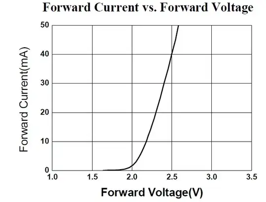

If you delve further into the spec sheets, you can often also find a graph like this one for a typical diode from the line.
Notice, like all diodes, the actual forward voltage varies depending on how much current you attempt to pass through it. Be aware that the graph and the max-min numbers are not the same thing. The graph has a similar left right variance between parts.

To drive the above LED from say a 5V source at a maximum of 20mA we would need to use the lower Vf value. That is \$R =( 5 - 1.8)/0.02 = 160\Omega\$.
We now need to check the lower and upper limits including the resistor tolerance.
\$I_{f_{hi}} = (5-1.8)/(160*0.95) = 21.05mA\$
\$I_{f_{lo}} = (5-2.6)/(160*1.05) = 14.29mA\$
That seems a little wide, so let's use the graph instead.
At 20mA the graph is indicating about 2.3V.
Using the formula that makes \$R =( 5 - 2.3)/0.02 = 135\Omega\$.
130R 5% is out closest resistor value so now we need to check both ends including resister tolerance.
\$I_{f_{hi}} = (5-1.8)/(130*0.95) = 25.9mA\$
\$I_{f_{lo}} = (5-2.6)/(130*1.05) = 17.6mA\$
You can see the variance is actually worse and the bright is a lot brighter so the first method was better.
