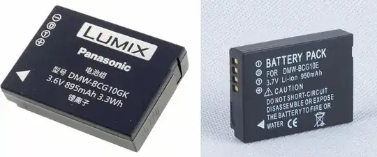

Panasonic DMW-BCG10
Connected our 4A powerpack ;-), must be enough and yep, we saw the first picture however the camera doesn't like the fake battery and shows us a message "This battery cannot be used" and turns off directly after this message. We also tried another battery, a LIPO, but same message.
There are some D and T pins on the original battery, this must be some kind of battery info data lines however we cannot find any info on this. We think it doesn't work because the camera cannot obtain some info from the battery or there is a problem with the camera itself. We want to know if we could use another battery, with same pin layout to fake the datalines. We don't know there is any standard. Before we try this, we want to know for sure there is no risk to damage the internals of the camera by doing this.

    D is likely a 1-wire connection that the camera uses to authn the battery. – Ignacio Vazquez-Abrams Dec 18 '17 at 20:23
  • Thanks for the link @Dampmaskin. Okay, 'T' is possibly the thermistor pin and 'D' the data pin? I see also some I2C stuff. We take a look at it. – Codebeat Dec 18 '17 at 20:24

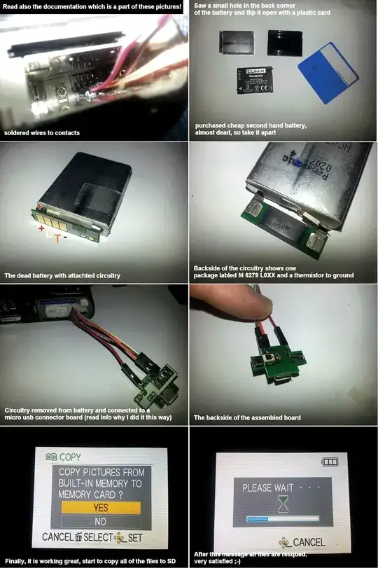

Allright, finally we done it! @KalleMP had the eye opener, however this was a slightly different battery (DMW-BLG10E instead of the DMW-BCG10E and it is fore sure another "valid and safe battery detection method"). It is not enough to fool a temperature sensor, you really need the battery IC (whatever it might be) to get it working. Also great thanks go to @SamGibson.
Purchased a cheap second hand original battery (doesn't know it will work either), just for three euro's, to use it as a donor battery, to reuse the circuitry inside this battery.
After disassembling the battery very carefully, I solder the salvaged board on a micro USB connector board for two reasons:
  • Easy and stiff connection;
  • It might be possible to use it on 5V because the camera is rated 5.1V (see experiment later on).
The first try didn't work, for some reason the board outputs only 0.7 volts when connected to a battery (3.7v). First thoughts:
  • It has something to do with smart failure detection/registration by disconnect the original battery (power disconnect = failure)
  • The circuitry was already in a failure state;
  • Heating up the board by soldering damaged the internals of the board.
By connecting the battery directly to the camera inputs and the circuitry (in fact in parallel) there was life! Now we are able to copy the data to SD-card, it works perfectly.
solution
USB Power possible? (warning: Just for science, use at own risk!)
After copying (for sure) all data we tried an experiment, just for science, connect it directly to USB (5V) because the camera is rated 5.1V. After a few hours the camera is still running fine, works great! I think it is still usable as photo/film camera with external battery or USB 5V powersource, neat.
This project is a success
