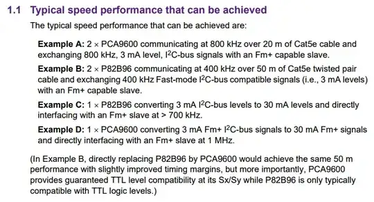

200 meters is pretty far to go for I2C, since it was originally intended for short-distance intra-board communication. However, using a bus buffer as you describe and running at lower clock speeds will make long cable runs possible.
This application note from NXP shows 50m performance for the PCA9600 you're looking at:
NXP app note
The PCA9615 is a related part that uses a differential I2C protocol, and is rated to 3 meter lengths at full speed (1MHz). I've used this part without issue operating at 400kHz over a 10 meter CAT6 cable.

  • sir i read some were that with pca9600 can increase the capacitance too 4000pf and 300m max length. did i get a wrong information.? – Sam Verghese Dec 18 '17 at 07:16
  • I'm not seeing that anywhere in the datasheet or app note, so while it may be possible (as claimed by the link below) you'd probably need to test to know for sure :/. https://sandboxelectronics.com/?p=1145 – bkeegs Dec 18 '17 at 17:46
