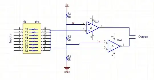

For minimal parts count, why not do it Analog?
Create a voltage divider with one resistor on top, and your 8 inputs connected to the bottom by 8 resistors in parallel. Then simply use two comparators set to detect the voltage levels that 2 or 3 bits will produce. That's only 6 parts:
Bit count detector
The 8-resistor network will produce a voltage between 0v (for 0-bits set) to 5v (for 8 bits sets). 2 bits will produce 0.5v. 3 bits will produce 1.56v.
  • With 0 or 1 bits, the output will be 00.
  • With 2 or 3 bits, the output will be 01.
  • With 4 or more bits, the output will be 11.

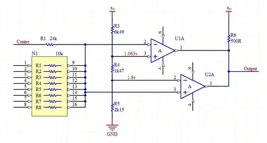

Thanks to DavidCary for an excellent suggestion. After a lot of calculating, I think I have found a set of resistors that work, but you should carefully check my calculations first. Here I am using comparators with open-drain outputs and I think I have managed to get it to have a single output. Low means dead next round, High means alive next round.
Conway's game of life circuit 2
The nice thing is that this circuit only has two more components than the other circuit. They're all E8 series resistors, so should be possible to get hold of. Also, R6 should have been a higher value, like 4.7k or something.

    Perhaps: Add a 9th "summing resistor" of 20 kOhm from the current state of the central cell to the op-amp "+" summing point in Rocketmagnet's circuit -- i.e., give the central cell a weight of 1 and the 8 neighboring cells a weight of 2. Then tweak the voltage divider so "birth" (central dead cell with 3 live neighbors; sum = 6) and "stay alive" (central dead cell alive with 2 or 3 live neighbors, sum = 5 or 7) gives outputs of "01"; and all other cases (where the central cell dies or stays dead) give outputs of "00" or "11". Then an XOR gate gives the next state of the central cell. – davidcary Jun 25 '12 at 14:24
  • @davidcary - I like this idea. Wire it up so that you get a single output which says Live or Die next round. – Rocketmagnet Jun 25 '12 at 14:41
  • That is genius, I guess I would just need to tweak the values of R1 and R2 to get the proper windows I care about. Any recommendations for values, and for suitable comparators? – captncraig Jun 25 '12 at 17:38
  • Your link labelled "This Page" is dead. Any idea what the title was? – Keegan Jay Sep 15 '17 at 15:05
    A few things Ive found doing some experimenting: the resistances are not quite right. I found a few better combinations but I'm still trying to optimize. Also, when making a grid of these, current will flow backwards through the summimg resistors and mess things up. Diodes on the interlinks are one way to prevent this. – captncraig Jul 22 '19 at 13:32
