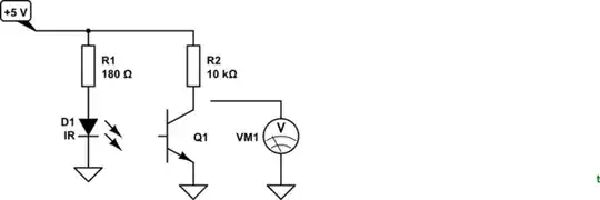

schematic
Figure 1. Test circuit.
Try to find the IR LED by powering up with a 5 V supply and a 180 Ω resistor. Most LEDs can tolerate 5 V in reverse so you are unlikely to damage it. View it through a camera.
That should leave you with two pins to identify. This is unlikely to be a transistor as shown in my sketch but eliminate that first. With the sensor covered the voltmeter should read 5 V. If the transistor turns on the voltage will drop. You could "drive it hard" using an infrared remote control pointing straight into the receiver.
Note that both lenses will have IR filters and so the receiver will not respond well to visible light.
