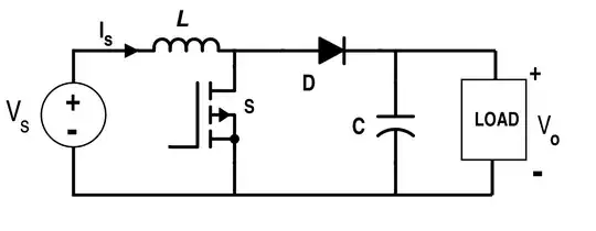

What you need is a boost converter, which will raise your voltage from 5V to 9 or even 12V, as you need. The schematics is quite simple, such as shown on picture below. enter image description here
For this project, I recommend you to use an already built one with regulated output voltage, which you will pre-set for the desired voltage, as your router requires. You can get them cheap on largest retail store on the web.
