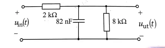

I'm studying my first year of electrical engineering and I am stuck with understanding how to determine transfer functions from different circuits.
As of right now I'm trying to determine \$\omega_1\$ and\$\ A\$ in the following transfer function. \$\ H(\omega)=\frac{A}{1+j\frac{\omega}{\omega_1}}\$
The circuit to be analyzed is this one: Circuit 10.3

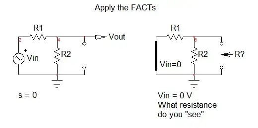

The other easier way it to apply the fast analytical techniques or FACTs introduced here. Your circuit includes one energy-storing element, the capacitor, so it is a first-order circuit. The stimulus is your source \$V_{in}\$ on the left while the response is the output signal that I called \$V_{out}\$. The mathematical relationship linking the response to the stimulus is called a transfer function. There are many ways to determine a transfer function. I have found that the simplest and most intuitive one uses the FACTs. Via simple manipulations, you can determine a transfer function without writing a single line of algebra, just inspecting the circuit.
First, you start in dc, \$s=0\$. In this mode, the capacitor is open circuited and you redraw your circuit in which the two resistances remain. The transfer function \$H\$ linking \$V_{out}\$ and \$V_{in}\$ noted \$H_0\$ in this mode is
\$H_0=\frac{R_2}{R_1+R_2}\$
Then, to determine the time constant of any circuit, you reduced the excitation to 0: your left-side voltage source \$V_{in}\$ is reduced to 0 V. Replace it by a short circuit. Then, temporarily remove the capacitor and, in your head, determine the resistance "seen" from its connecting terminals in this mode. See below:

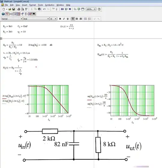

You see the parallel combination of \$R_1\$ and \$R_2\$. The time constant is thus \$\tau=C_1(R_1||R_2)\$ and the pole is \$\omega_p=\frac{1}{\tau}=\frac{1}{C_1(R_1||R_2)}\$. The transfer function is immediately determined in the low-entropy form as \$H(s)=H_0\frac{1}{1+\frac{s}{\omega_p}}\$ with the values you have determined. Mathcad can help you plot this expression quite quickly:
And now the icing on the cake, exclusive to the FACTs. What if you add a small resistance \$r_C\$ in series with capacitor \$C_1\$? Well, just by inspection, without writing a line of algebra, I can see there is a zero located at \$\omega_z=\frac{1}{r_CC_1}\$ and the new pole becomes \$\omega_p=\frac{1}{C_1(r_C+R_1||R_2)}\$, the dc gain remains the same. The updated transfer function in a low-entropy forms becomes \$H(s)=H_0\frac{1+\frac{s}{\omega_z}}{1+\frac{s}{\omega_p}}\$.

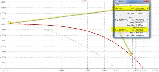

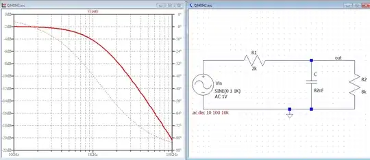

Here are the results of an LTspice AC simulation of your circuit:
A zoomed image of the graphics with cursors enabled confirm the above analysis:

You've calculated the total impedance from \$U_{in}^+\$ to \$U_{in}^-\$, that won't do us much good. Let's do this the right way.
I hope you can see that the output is part of a voltage divider.
$$ \begin{align} U_{ut}&=\frac{82 nF//8 kΩ}{2kΩ+82nF//8kΩ}U_{in}\\ \\ \frac{U_{ut}}{U_{in}} &=\frac{82 nF//8 kΩ}{2kΩ+82nF//8kΩ}\\ \\ \frac{U_{ut}}{U_{in}}=H(\omega)&=\frac{\frac{1}{j\omega82×10^{-9}}//8000}{2000+\frac{1}{j\omega82×10^{-9}}//8000}\\ \end{align} $$
I believe you can take it from here.
