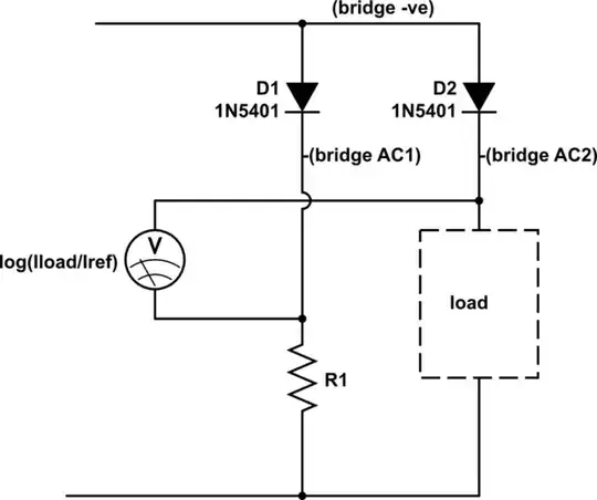

How much accuracy do you need? If you only need an estimate, then a series silicon diode will give you more or less logarithmic indication over a wide range of currents.
The main problem with a diode, the variation in voltage drop with temperature, can be significantly mitigated by running a second diode at the same temperature with a reference current. Two diodes within a rectifier bridge would be thermally coupled and ideal for this, I've marked the connections on the schematic, bridge +ve stays unused. As your load is very low power and the high currents are only short pulses, even two individual diodes taped together should be OK. A 1N540x for instance is good for 3 A continuous and will still have a significant forward drop at 100 µA.
It has the advantage that the load voltage changes very little, perhaps a few hundred mV between 500 µA and 1.5 A, much less than with a resistive shunt that will measure mA.
schematic
Replacing R1 with a current sink would make the reference current more accurate, but (power supply voltage - 0.7 V)/R1 is probably adequate for most purposes. Ideally, the reference current would be in the middle of the range you want to measure best. Somewhere in the 1 to 10 mA range feels good.
The voltmeter reading will be proportional to the log of the ratio of load to reference current. The output impedance from the diodes is very low, so amplifying the difference with an opamp, perhaps to scale it or to ground-reference it, will be straightforward.
You will need to calibrate the measurement conversion at high and low currents to establish the log law, and it would be good to check it at a few points in between. Remember that calibrating at high current will heat the load diode, so you may need to use short pulses, as short as your transmit pulses, to minimise thermal drift errors.

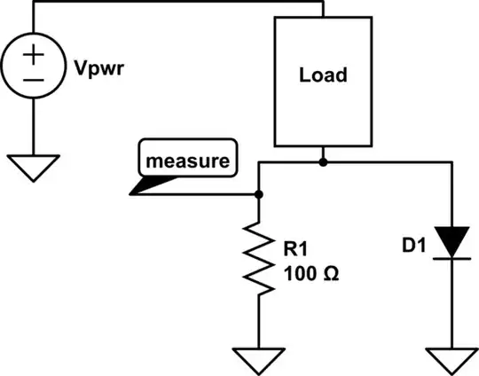

An extension to Neil_UK's answer, if you need decent accuracy on sleep current but don't care about measuring high current with the same circuit, is to put a diode and resistor in parallel:
schematic
This way, when the current is low, the voltage across the resistor will be nicely proportional, and it will be low enough that the diode is effectively off, so it doesn't shunt too much of the current away from the resistor (though check the specs on your diode).
When the current is high, the diode is conducting and limiting the voltage drop to some reasonable value. If you want to measure the current at this time as well, you can add another shunt in series, like so (idea courtesy of @dim):

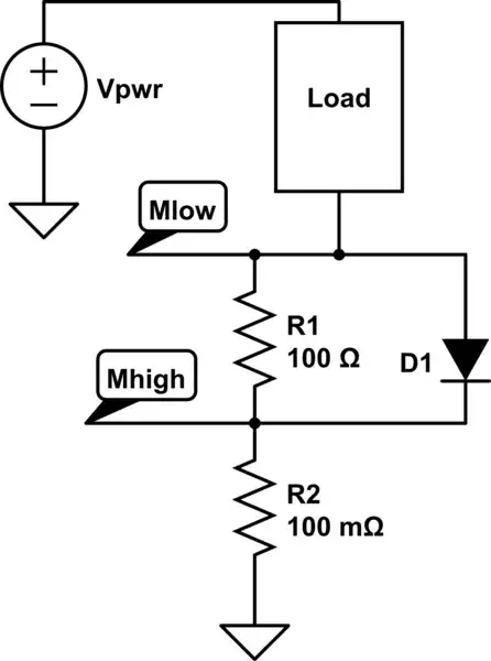

schematic
simulate this circuit
Abe Karplus
  • 2,621
  • 14
  • 19
    You could even have two shunts: one with a ~0.1Ohm value for the high currents (without diode), and one 100ohm with the diode in parallel for the low currents. This way, you can accurately measure both ranges and the worst case total drop will be limited to ~1V. – dim Nov 18 '17 at 18:46
  • @dim Yes, though one of the shunts would no longer be ground-referenced, so for testing I'd just swap them manually. – Abe Karplus Nov 18 '17 at 20:47
    If you put the lower-value, high-current shunt closer to ground, the error will be negligible when you measure low currents. Or use a 99.9ohm value for the other shunt to compensate. – dim Nov 19 '17 at 03:13
