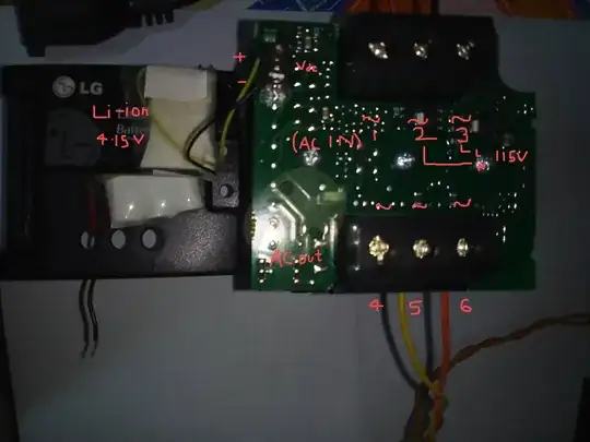

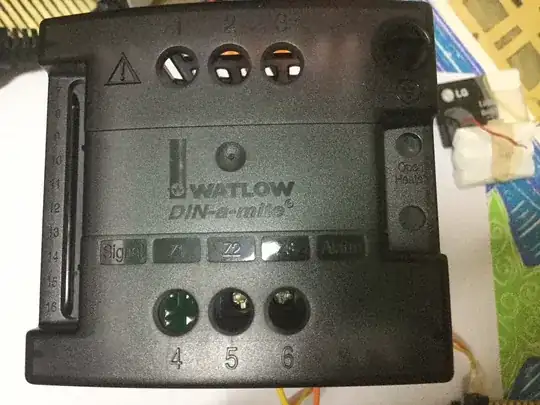

This is kinda noob question. I recently got an SCR Power controller (WATLOW DIN-a-mite DB20-24CO-0000 Style B). This is the first time I actually got to test an SCR controller for myself. The input trigger is 4VDC to 32VDC, which I powered with a fully charged Li-ion at 4.1V . AC input:115VAC from 12V inverter and out is a 115V digital panel meter (I wanted to try first with a low powered device) though its meant for a heater.
As per the specs the SCR is rated for 25Amps. Similar or even higher rated current relays are available and much smaller in size.
So,is there any specific reason for using an SCR power controller over a higher current relay/contactor? Also, is an SCF power controller same as an Solid State Relay?SCR wired to run a digital panelSCRSCR Spec

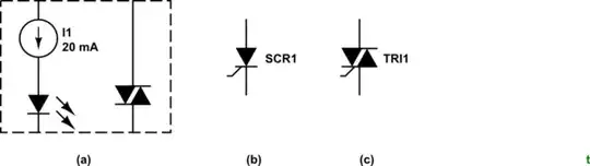

Also is an SSR almost same as SCR triggered controller?
schematic
Figure 3. A very simple SSR (a), a thyristor (b) and a triac (c).
An SSR (a) will have electrical isolation between the trigger circuit and the actual SCR. An SCR controller might not and, at its simplest, might just be a thyristor or triac. Note that in Figure 3a I have shown a constant current source to represent the internal circuitry that allows the SSR to work over a wide range of input voltages - 4 to 32 V in your example.
