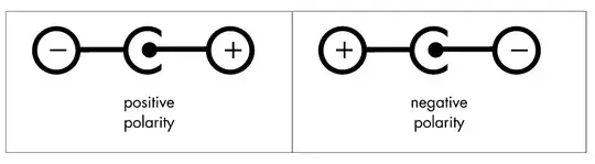

Unless there is a figure like below, or some wording like "positive centre" then you can't tell.
DC markings
or:
A supply can use positive or negative centre, as Olin says there is no standard. This is why you get the polarity switches on many of the universal DC supplies.
