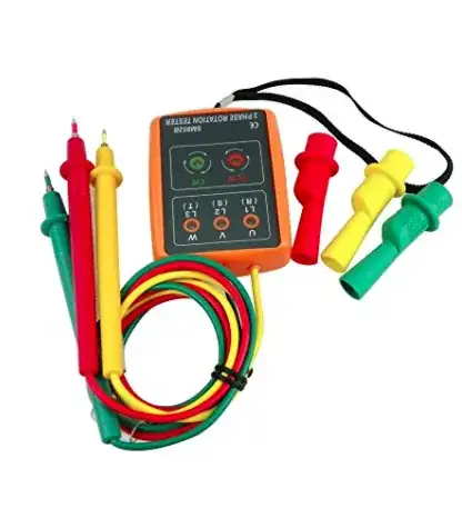

They sell testers for this purpose starting at < $20- sometimes running in reverse can cause severe damage to machinery.
I would not trust that the convention was followed even if there is one, in such a case.
I also cannot recommend the cheap testers, especially on > 240VAC due to potential for arc flash and such like- a real and appropriate CAT number should be present. Something from a reputable maker might be more like $150 (the one shown above is of the former category and is sold on Amazon- meaning that they probably are required to carry enough liability insurance to cover your next of kin).
Older testers actually had a small 3-phase motor and you would observe the direction of rotation, but newer ones are generally electronic.

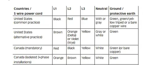

Directly in answer to your question, the color code is listed as "common practice" in the US and "mandatory" in Canada as follows (somewhat unofficial source here):

  • I expect the colours "red, blue and yellow" - what's green? – Solar Mike Nov 10 '17 at 21:35
  • @SolarMike Yellow, Green and Red are Chinese standard for 3-phase. Green + yellow stripe is ground. I said it was a cheap one. ;-) – Spehro Pefhany Nov 10 '17 at 21:44
  • at least green & yellow stripe is the same... – Solar Mike Nov 10 '17 at 21:53
  • @SolarMike Aye, that's the one that will kill ya if done wrong. – Spehro Pefhany Nov 10 '17 at 22:01
    I'm not asking about the color codes. I'm asking about the actual phase relationship between L1, L2, and L3. – Rick Nov 11 '17 at 00:08
