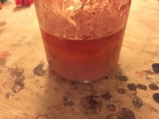

This is how it looks after I haven't touched it for 24 h, the ABS has sunk to the bottom and some acetone is on top. Maybe the ratio is closer to 60/40. Either way, you will get something, you can't really fail.

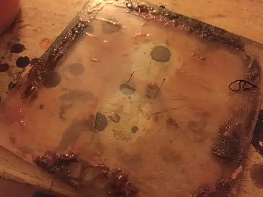

This is how it looks like after I've applied a layer on a piece of glass. I use it for 3D printing, and what I've learned is that the less ABS you have in your ratio, the thinner the layer will be, and the weaker it will stay on the surface. The bubbles as you can see on the surface is from when the glass is heated up to 100 degrees Celsius which you need to do in order for the 3D print to stick properly to your heated bed. If you allow the acetone to evaporate slowly, rather than boiling it off as I did, then there won't be any bubbles. The outer black area is from when I used black ABS-juice, my red ABS-juice hasn't discolored or anything.
The messy table is from me not caring about the mess I do on the table, so the black stains is from when I used black ABS-juice.
