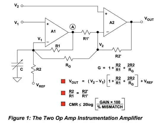

The top two amplifiers are configured in what is often just referred to as a "2 opamp instrumentation amplifier" (as opposed to the the more common 3 opamp version). enter image description here A tutorial from Analog Devices describes it here Two opamp instrumentation amp description
A3 is to buffer a filtered and attenuated version of the voltage at Val for use elsewhere in the system - it is not part of the main differential amplifier.
