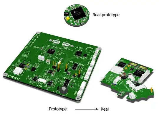

I work for a very small company, making very small numbers of PCBs, so the way we make prototypes is probably more similar to the way David Kessner does it. We are usually very short on time and funding, so we often really need to try to get it right(ish) first time, and if it's not, then we just have to patch the boards by hand.
The thing that makes our PCBs unusual is that, being in robotic devices, we are always desperately pushed for space, and that space is usually a stupid shape. When I design a prototype, the question I'm trying to answer is: 'Is it feasible for these components to fit in this space?' That prototype will sometimes only exist in CAD, but I have to get most of the way through the layout before I can be sure that the design is feasible. Having done most of the design work, I'll then sneak that design onto a spare bit of space on the next PCB run we do.
For example, this little round PCB is only 15mm diameter, but has 49 components on it, and also needs space for wires to solder onto pads, for power, communication and programming. I did the layout to see if it was possible. It was, so I had one made.
PCB Prototypes
Having said that, for a more complex board, it really is worth laying out a large one, for probing and scoping. This design was laid out at 100x100mm (massive!) and was invaluable for debugging. Then it was laid out on that funny shaped board which was a nightmare of physical constraints, making it hard to add debugging features. I was very glad to have had the prototype.

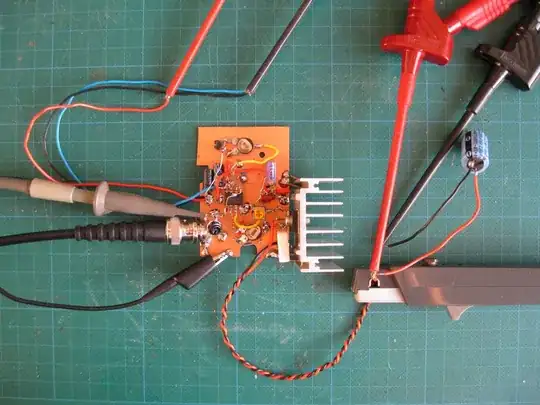

My favorite way of prototyping whenever I want to check some small details before trusting a draft or simulation and putting a small block onto an expensive multi-layer PCB with anything between 100...1000 other components:
Breadboarding. With copper-clad boards.
Voltage-Controlled Current Sink Circuit is roughly similar to fig. 6 in LT's AN-104
enter image description here Source: https://electronics.stackexchange.com/a/15059/930
enter image description here This was a quick check for a voltage regulator design I needed at work and wanted to try before having a big PCB finished. It looks messy, and this is exactly the big advantage: 30 minutes in your home lab will save days of re-designing your project because you missed one tiny (and obvious?) gotcha.
... Just three tiny examples, but you get the idea. It's quick and (sometimes very) dirty, but you can keep short whatever needs to be kept short and achieve good results very fast. A very good tutorial can be found on p. 28-31 in Jim Williams' App Note 47 on the LTC website.
Of course, this will not work for BGAs and the like, but whenever I need just a tiny hack, this is my favorite way to go.

  • It must be nearly impossible to move it. What do you do if a colleague is developing another component and you have to test them connected to each other? – finnw Jun 13 '12 at 21:01
    These breadboards take more abuse than one would think. One of the most beautiful examples can be found here: http://cds.linear.com/docs/Application%20Note/an120f.pdf – zebonaut Jun 14 '12 at 09:27
  • @zebonaut - Beautiful? I don't know how those people can show their face in public after that. – Rocketmagnet Jun 14 '12 at 15:32
