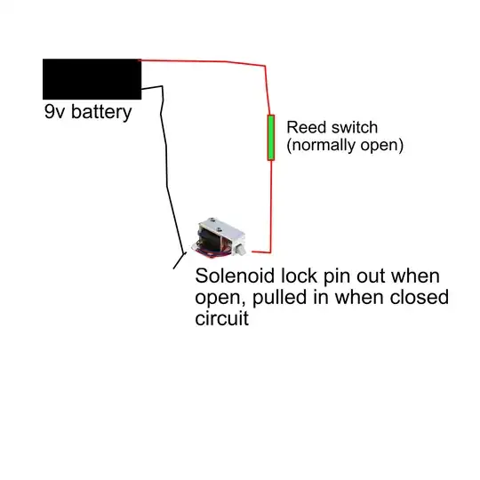

The (normally open) reed switch should close by waving a magnet across it, completing the circuit. The 6v solenoid lock should pull inwards allowing the door to be opened. When the magnet is removed the reed switch should open.
So my issue is the solenoid pin isn't being pulled in when 9 Volts is applied. It only pulls in when pressed three-quarters of the way in. This made me suspect the voltage wasn't right but tested showing 9V. I tried two others batteries with the same results. I also tried putting two 9V batteries in series to make 18V, but the solenoid would only operate if pin was pushed in half way. ($%£!!!) I also noticed on both the 9V and 18V that the reed switch would get stuck in the closed position.
Any ideas would be greatly and deeply appreciated.

    Easy troubleshooting step: get rid of the reed switch and manually connect the battery to the solenoid. If it works, then your switch is dropping too much voltage. – Shamtam Oct 26 '17 at 16:35
    This is such a target-rich environment. The reed switch is being abused, a wimpy 9 V battery attempting to run a door lock solenoid, no flyback catch diode, and not even a real schematic. – Olin Lathrop Oct 27 '17 at 19:50

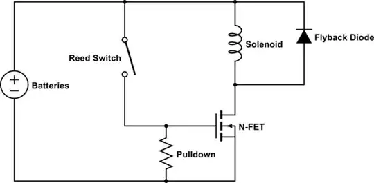

To solve the problem, you should use the reed switch to signal some other, less delicate, device. Then, this device should switch power to the solenoid. Common solutions would be either a MOSFET or a relay.
Here is a simplified MOSFET example:
schematic
It includes a pull-down resistor and a flyback diode (sometimes called "anti-kick diode"). If you like, please see this answer for why they are required.
The second problem is that you need to provide enough power to your solenoid. It sounds like yours is rated for 6V.
If you are giving it the rated voltage and it isn't working, then you probably aren't able to supply enough current. 9V batteries have a high internal resistance, and so can't provide much current. You could put 4 AA batteries in series to get 6V and it could supply a lot more.
By the way, solenoids require a lot of current. AA batteries might not be sufficient. Do you know the current specification for your solenoid? You may need a dedicated power supply.
By the way, don't just increase the voltage! If you exceed the rated voltage you can cause failures in the solenoid.

  • Measure the resistance of your solenoid and work out the current draw at 6V. Then you'll know if there's enough current capacity in the batteries you are using. – Ryan Griggs Oct 26 '17 at 18:07
  • Hi Ryan, I measured the resistance of my solenoid and it's 17 Ohms.. under the spec for the lock it tells me at 6v it should draw 0.476 which makes it about 12.6 ohms (active) so could this be the issue? – Dominic Edwards Oct 26 '17 at 19:33
    @DominicEdwards half an amp or so is definitely beyond the reasonable load for a 9V battery (they're best suited for 10-100mA). Good ones might be able to do it for a short while, but even then they might get dangerously hot. – hobbs Oct 26 '17 at 22:13
