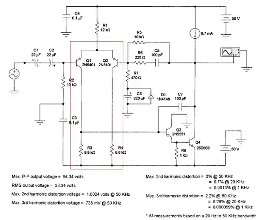

This question refers to audio amplifier design, using BJTs only.
I am wondering how differential stage amplifier plays an important role in hi-fi audio amplifiers. According to this book (where picture was copied from) I have, a part of output signal is feeding the base of Q2. Q1 and Q2 somehow amplify input signal and at the same time cancel out some of distortion that is being brought back from the output to the differential input stage of amplifier.
  • I want to understand the process of this differential stage and how it manages to cancel out some of the output distortion.
I almost completely understand functions of other transistor stages so there is no need for explaining how the whole circuit works.
*Source: G. Randy Slone : High Power Audio Amplifier Construction Manual

  • The negative feedback reduces the distortion, not the differential pair by itself. The differential pair act as an error amplifier. He compares the input signal (not distorted one) with the output signal. So, the error signal is created to cancel the distortion. Exactly in the same way as a negative feedback "brings back" the output signal to the equilibrium state (V"+" = V"-"). The negative feedback does not distinguish between types of disturbances. – G36 Oct 23 '17 at 14:18
  • If for some reason the Vout is different than expected the negative feedback will correct it. If Vout is larger than expected (Vin) the Q2 will reduce his IC current. But in the same time, the Q1 Ic current will goes up. Q3 and Q4 current will also increase so the Vout will drop. – G36 Oct 23 '17 at 14:32
  • Note how the name "differential amplifier" relates to the fact that the amplifier (with a differential pair at its input) amplifies the difference (voltage) at its input. By amplifying the difference and feeding it back as negative feedback, the difference is minimized. And zero difference means no distortion. – Bimpelrekkie Oct 23 '17 at 14:46
  • In all cases and for each amplifier type the effect of negative feedback always reduces non-linear distortions. This was proven - independent on a particular topology - for all active blocks with negative feedback (H. Black in the 1930th). – LvW Oct 23 '17 at 15:07
  • @Bimpelrekkie Seems logical to me. But how does Q2 do anything since there is no output taken on that device? Or does the Q2 transistor affects the Q1 transistor? – lucenzo97 Oct 24 '17 at 12:23
  • But how does Q2 do anything since there is no output taken on that device? There is! Through the feedback network (basically R5 and R7+C6) this is a voltage divider which takes the output voltage, divides it (by roughly 470/10470) and feeds that to Q2. I hope you understand that at the base of Q2 there is a divided-down version of the output voltage which the amplifier tries to match (compare, amplify difference) with the input voltage which is at the base of Q1. – Bimpelrekkie Oct 24 '17 at 12:33
  • Oh, I misunderstood you in my previous comment! What you mean: the collector current of Q2 is not used! That's correct but it does not matter. The sum of the collector current of Q1 and Q2 remains constant. So if Ic_Q2 is a bit larger then Ic_Q1 will be a bit smaller. So we can "throw away" Ic_Q2 because Ic_Q1 contains the same information. Why is Ic_Q1 + Ic_Q2 constant? Because of R1, it forces a nearly constant current into Q1 + Q2. – Bimpelrekkie Oct 24 '17 at 12:37
  • Ideally R1 should be a current source but since there's almost 50 V across it, it will be good enough. The voltage at the emitters of Q1 and Q2 does not vary much (very little compared to 50 V) so the current will be reasonably constant. – Bimpelrekkie Oct 24 '17 at 12:41
  • @Bimpelrekkie Yes, R1 should be replaced by constant current source and R3&R4 should also be replaced with current mirrors for optimal balance. – lucenzo97 Oct 24 '17 at 12:56
  • You could try that in a simulator and see how much difference it makes. My bet: it will not make a lot of difference. As long as the open-loop gain is much higher than the closed-loop gain then any imbalances in the loop are suppressed. – Bimpelrekkie Oct 24 '17 at 13:10
  • @Bimpelrekkie You said this: "So if Ic_Q2 is a bit larger then Ic_Q1 will be a bit smaller.", so that means if Vbe_Q2 increases a bit more then Vbe_Q1 will decrease for the same amount? – lucenzo97 Oct 24 '17 at 15:30
