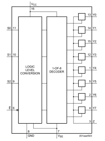

Take as an example the common 74HC4051 analog mux:
Here S0, S1 and S2 are the selection inputs, /E is the enable input (all four pins are digital), whereas Y0..Y7 are the analog data inputs and Z is the analog output. Note that in this case you can also reverse the role of the analog inputs and output and get a demultiplexer (a.k.a. DEMUX).

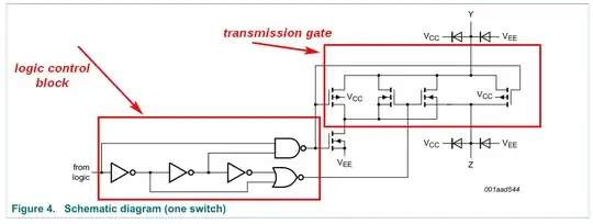

In particular, see how a single switch is implemented:

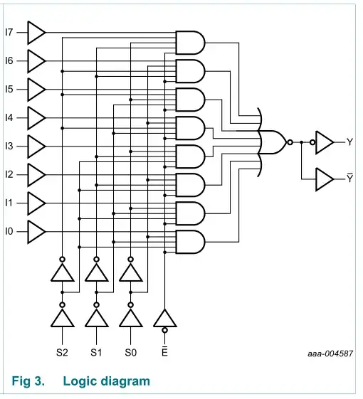

Take as an example the common 74HC151 digital mux and its internal logic diagram:
In this case they use I0,I1,...,I7 for the data inputs and Y for the output (they also provide a negated output for free).
  • Why is the wierd logic control block in the analog multiplexer so? The exact same logic could be made with a single not gate, so is this for timing? – Jonas Daverio Dec 03 '21 at 05:04
