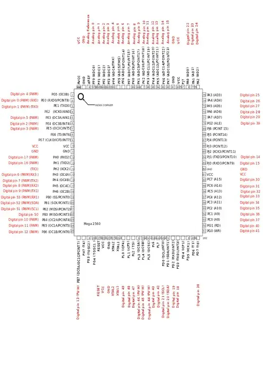

In response to your comment - that's easy! You need to assimilate two diagrams worth of information to pull it off. The first is the Arduino / ATMega2560 Pin Mapping.
The second is the ISP Header / AVR Pin Mapping:
Armed with these two pictures, you should be able to see how to wire it up.
  • Run a wire from DIG50 to Dragon ISP header pin 1
  • Run a wire from VCC to Dragon ISP header pin 2
  • Run a wire from DIG52 to Dragon ISP header pin 3
  • Run a wire from DIG51 to Dragon ISP header pin 4
  • Run a wire from RESET to Dragon ISP header pin 5
  • Run a wire from GND to Dragon ISP header pin 6
With those in place, you should be able to use AVR Studio to read the Hex file off the chip - let me know if you need more guidance.
