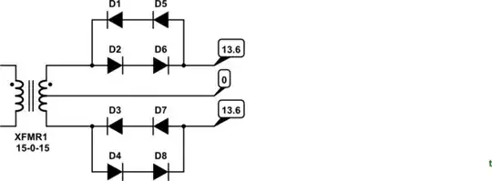

Figure 1. Adding back-to-back diodes in the 15 V output lines will reduce the voltage on each line by 1.4 V.
You need to select diodes capable of 3 A. Be aware that at low output currents the voltage will rise as there will be lower forward voltage drop across the diodes.
